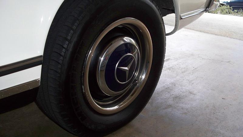

« Reply #3 on: February 25, 2008, 20:00:36 »

Ahhh John, I can only hope mine turn out so nice. Did you use an exacto to get the final edges?
Also, I am guessing these are from the 190? what is that small rectangular piece?

Yes, great pics (seen them before) and love the finish but some explanatory words would paint a thousand hubcaps!

I'd like to help, but I didn't paint them.  They were done by the shop.  I assume they used various widths of masking tape, obviously the thinner tapes can be contoured much more precisely.  I suspect on the outer rim, they used thin tape for the inner cut line and then piled on the wider stuff to cover.  I'm sure a sharp trimming knife fits into the picture, but some of these tapes are 1/8" thick.  You would need to visit a professional paint supplier, preferably with a hub cap in tow to get advice.
The rectangular piece is the radio delete plate without the logo.
