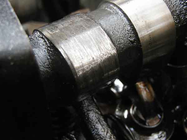

- - one more thing JP,
Be sure and check the camlobe for scuffing on the one that was running too tight. Several of mine were damaged beyond repair.  Larry in CA

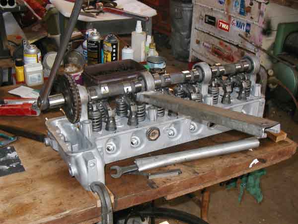

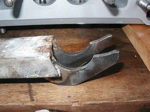

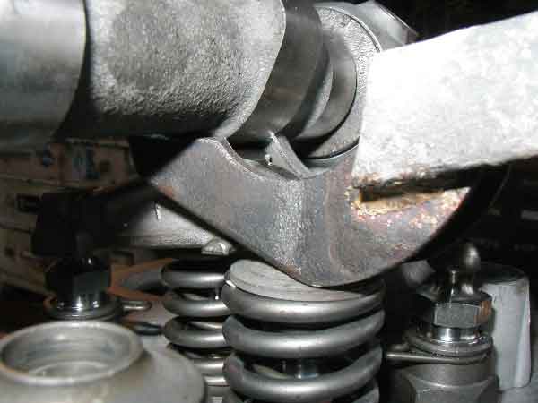

Being frugal to a fault - - - I refused to buy a tool I would only use once every couple of years so I came up with a better idea. The photos illustate the use of a special tool I made to facilitate the valve adjusting operation.
By slipping the rocker arm out of the way you can make the fine adjustment on the ball stud by using a 1/2 in drive deep socket instead of the HAZET tool. Then just compress the valve spring, slip it back in between the forks of this tool,  and recheck your adjustment.
For what it's worth - - Larry in CA
