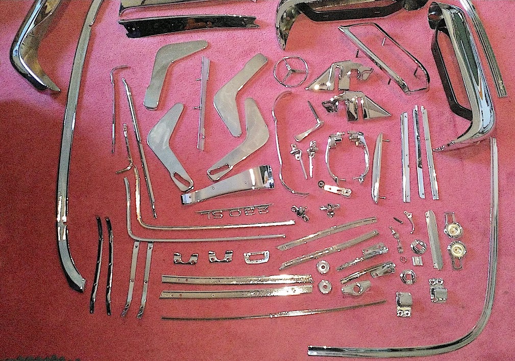

Still waiting for some small parts, but these are the parts with new chrome.
Again something else.

Awesome, simply awesome! :o :o :o

very nice. Must be a good size investment with all of that chrome. Both blues are beautiful, but I definately agree that you havr to see them in person.  Pictures can be deceiving in different light.
