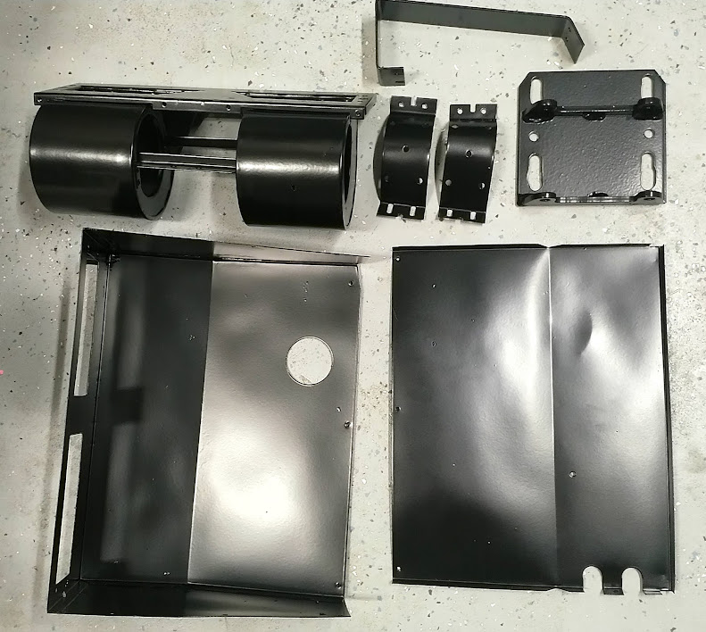

OH man, something I look forward to doing; renovating the AC.
As aforementioned in another thread, when putting the AC box back together, I would block, or severely limit, the amount of airflow on that far right side vent.
Otherwise, 90% of the air flow will go through that vent and hardly anything out the center/left vents.
I'd replace:
blower motor, expansion valve, switches, and drier.  Definitely test the evap for leaks.  If it's suspect, I'd get a new one if they're available???

« Reply #176 on: October 09, 2019, 15:31:22 »
Some metal parts have been blasted and powder coated, what a difference that makes!

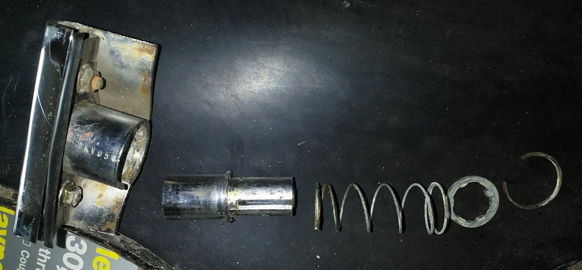

Today I reassembled the hatch and door locks which have new chrome.
New keys have been made fitting in the locks, because there was only a ignition key with the car.

doitwright
  • USA, IL, Willowbrook
  • Posts: 663
Re: Dutch 230 SL Pagode 1965 restoration project
« Reply #199 on: February 03, 2020, 20:55:34 »
In your photo showing your AC components I did not see the compressor mounting bracket. I see the Adapter plate for the rotary compressor. Do you plan to use the big beast bracket or one sourced from a sedan? The sedan bracket allows mounting the alternator in its original non-AC car location. The big beast bracket requires you to move the alternator up and place the compressor in the alternator position. Most find that the big bracket makes servicing the engine more challenging. Using The sedan bracket also requires a different upper thermostat housing with a taller neck so the radiator hose can clear the sedan bracket.
