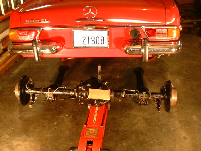

I put a 3.27 in my car. Makes a whole new automobile out of it: I cruise at about 3000 RPM on the freeway at 63MPH. I do not feel that the car is slower off the line, but it should be. If I really want to beat that Audi or Porsche, I start in first gear. My cost was $250 for the axle plus new bushings, maybe another 50 bucks. It's quite a bit of work and you have to be careful removing the compensator spring. But if I can do it, so can you. The attached picture shows the new axle ready to install
Download Attachment: RearAxle.JPG
82.66 KB
Re: Rear Axle Modification
« Reply #2 on: September 02, 2004, 11:26:27 »
This car does not have a spedometer. But it has the original speedometer and it now reads 25% slow; i.e. 40MPH is really 50. On the funny side: 50MPH is 62.5MPH which is exactly 100Km/hr. So I made stickers to go on the glass in a few places, like at 30 (is 38) 50 and 60 (is 75). That takes care of our usual posted speed limits. Because of my extensive education I am also able - sometimes - to multiply the indicated speed by 1.25. It is especially easy when the speedometer indicates 100MPH
