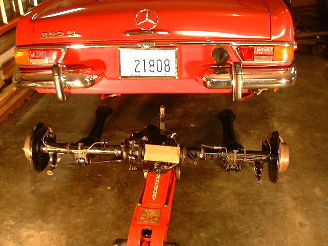

Attached is a picture of when I changed to a 3.27 axle. I have an automatic. I do about 3100 rpm at 62.5 MPH (100 km/hr). My last fill-up indicated about 22 MPG. Acceleration has never been a problem, but if you drive like that, you'll get less MPG's. This morning I accelerated away from a Lexus, up a steep hill. He wanted to race me. Left him in the dust. My file indicates that the picture was taken in Feb. '04. I have had the axle in for that long. I have no desire to go back. I didn't recalibrate the speedo. I can multiply the indicated speed and milage by 1.25 (on good days only) Officer - I was only doing 60!
Download Attachment: RearAxle.JPG
82.67 KB
