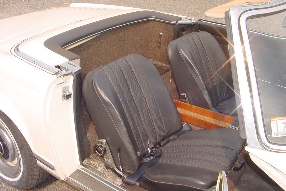

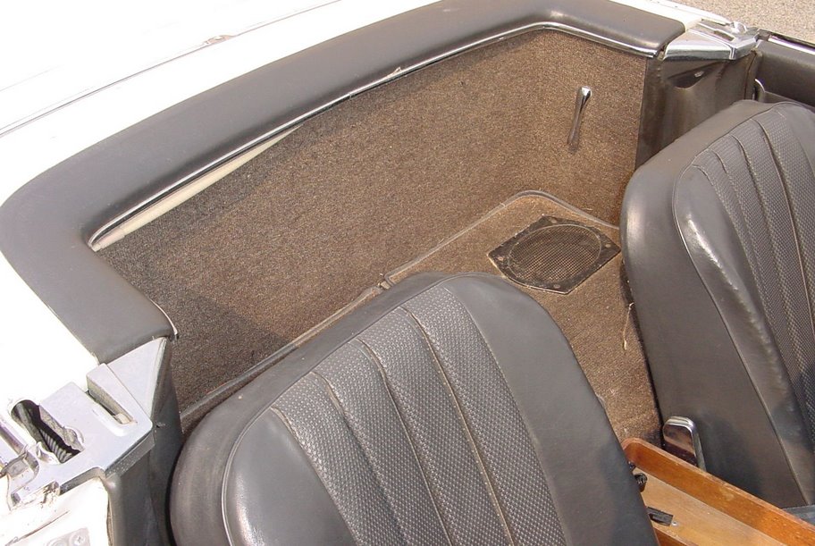

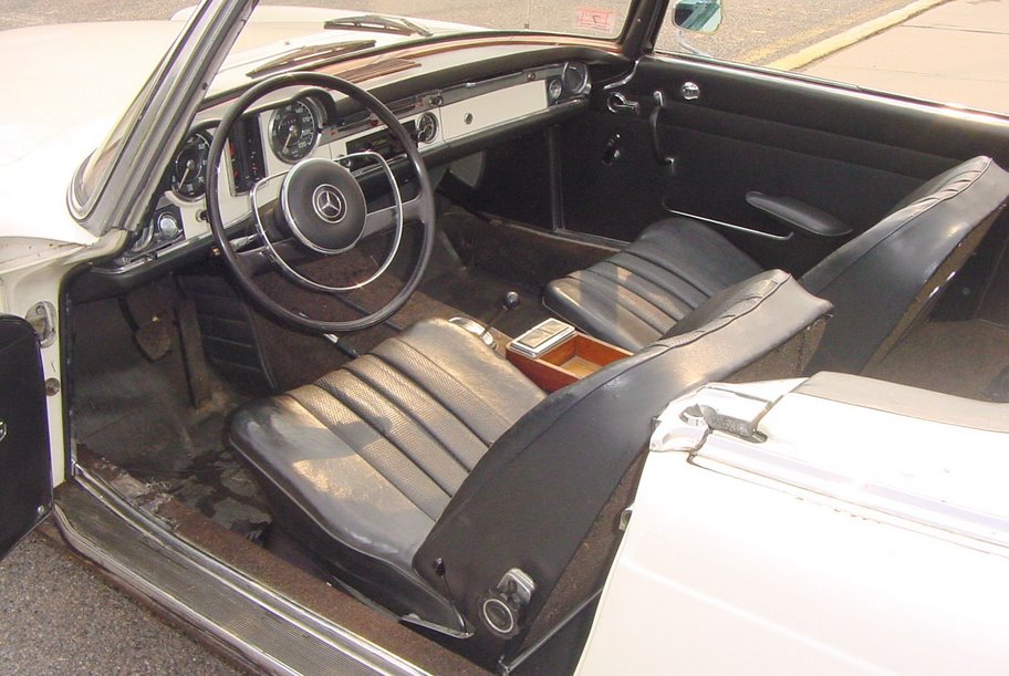

Here you can see the current status
Download Attachment: Image029.jpg
115.08 KB
Download Attachment: Image033.jpg
149.77 KB
Download Attachment: Image049.jpg

Your car appears to be painted in some beige or white color, correct? It is difficult to see but are the seats and doors black or dark brown? And is this the original color combination as indicated on the data card?
Montearenas
Re: Correct carpet for my 230SL
« Reply #5 on: October 21, 2008, 17:19:54 »
The car is on White whith doors and seats in black,
The carpet have a undefined color (braun / grey / Black) in very bad condition.
I'm thinking what is the best color option for my car.
