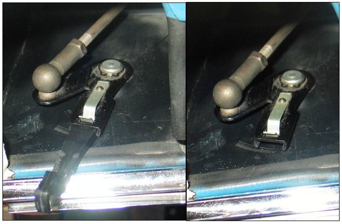

The vent does not have to be removed, although it is easier if you've already got them removed. But removing the vent is a royal PITA. You should be able to get a small screwdriver (I used a large jeweler's screwdriver) in where you see the plastic stick into the metal. Again, only going by recollection here, but there is a spring loaded catch that needs to be pried upward while the lever is pulled out. In the picture provided by 66andBlue, I believe the bright metal part is the catch. Seems like mine was either black or rusty, because I don't recall any bright metal in there.

Since I had to reset the radial chrome vents I took better pictures to show how the lever is kept in place by a pressure clip.
However, it turns out - at least on my car - that the clip does not lock the lever in very firmly and it can be pulled out without the need to release the clip.

...However, it turns out - at least on my car - that the clip does not lock the lever in very firmly and it can be pulled out without the need to release the clip...
Same here, just a firm yet gentle pull and out they pop
