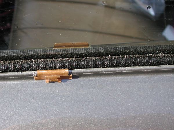

The door glass trim is held in place by two sets of clips (with barbs). They have to be pryed up, but place a hard card/plate below your implement to save damaging the door panel.
Will try to find you some pictures later.

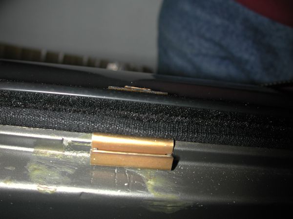

Door card hangs on inner 'whisker clip:
Chrome trim held by outer 'whisker clip' + a second clip in the chrome strip itself:

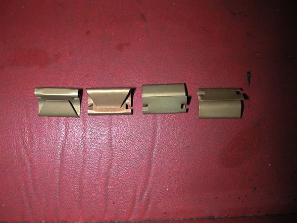

And the Chrome trim clips:

Anyway, I'm not clear as to the exact steps to be followed in removing the two pieces. There seem to be two types of clips involved:
Clip 1:
clip 2:
Clip 1 belongs to the felt strip and Clip2 belongs to the chrome strip. To remove the chrome strip, my first guess would be that you locate Clip2 it where it's concealed under the strip, and pry up it up off the metal lip of the door (protecting the paint with a card or whatever)?  This way you're lifting the clip and the chrome strip together? My first choice would not be to try to pry up the strip itself, though I could imagine that a combination of lift and rotating it toward you might work. In any case, can you tell me how it should be done?

Clip 1 belongs to the felt strip and Clip2 one belongs to the chrome strip (though it's not part of it). To remove the chrome strip, my first guess would be that you locate Clip2 it where it's concealed under the strip, and pry up it up off the metal lip of the door (jprotecting the paint with a card or whatever)? This way you're lifting the clip and the chrome strip together? My first choice would not be to try to pry up the strip itself, though I could imagine that a combination of lift and rotating it toward you might work. In any case, can you tell me how it should done?
According to the parts list, there are 5 of Clip1 and 6 of Clip2 on each door. I personally did not remove the strips, but I imagine prying will remove the strip and the sealing rail may lift at the same time....

Thanks, Naj. I misspoke. I meant say that in every other post they described plastic clips holding on the chrome strip, which invaribly broke if you removed them and had to be replaced. Maybe this is true of N. American cars?
I did manage to get the chrome stip off (as I told Van, a case where you ask the question and the answer comes to you, but you need the forum to ask the question). Interestingly, there were three clip1's and only one clip2, but the chrome strip definitely wasn't going anywhere.

Hello, Alfred,
Clip1 fits on the door and holds the whisker strip as well.
Clip2 fits on thr door trim strip and attaches to the door rim directly. It should be spaced to fit inbetween clips1.
