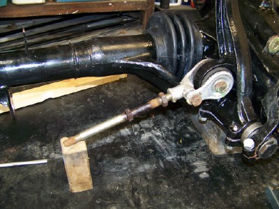

I am in the process of re building a 3.46 axle from a 1971 280SE 3.5 and now need to order some new seals and rubbers and confirm which SL bits will just transfer across. Does anyone know which parts are not interchangeable with the SL axles. I know the wheels bearings are both taper rollers on the SE and whilst the diff casing and internals are different it seems that all other parts should be the same as for the SL i.e. disks, callipers, Diff carrier, handbrake parts, trailing arm mounts, bearing seals etc. Does anyone know if this is correct?
David Brough
1969 280SL Auto with A/C
  • Posts: 7513
Re: 3.46 Rear Axle Rebuild
« Reply #1 on: April 02, 2008, 04:36:25 »
Hello Davic,
Everything should be the same except the handbrake cables. You will need to get plugs to close the connection for the cooling tube.  Two oil pan drain plugs (14mm allen style) will work nicely. The expensive barrel roller wheel bearing was desinged to be able to hinge along with the axle casting on the right side. I always use one of these on the right side. I have never seen one of these fail. They are very durable. On the other hand I have replaced many standard roller ball bearings on these axles.

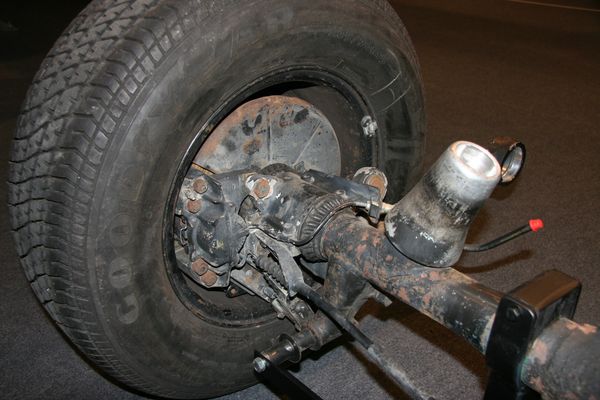

« Reply #6 on: April 03, 2008, 03:31:32 »
Originally posted by ja17
Hello David,
That is new information for me on the brake calipers being different. It would be nice if someone could verify different part numbers for the W113 rear caliper and a 250S (W108) rear caliper so this doesn't keep me awake tonight!
Its nice to know these things.
113 Rear Calipers (Same as 250S, 280SE...)
000 420 4683 left
000 420 4783 right
280SE 3.5:
002 421 5498 left
002 421 5598 right.
The good news is that the mounting holes on the axle tube should be the same. All use the same mounting plate with the 2 captive nuts: 108 420 0286.
Now, the W100 rear axle - thats something else!!!
Picture to follow.

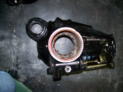

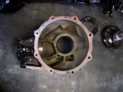

Work is progressing with my axle rebuild but I think I may have hit a snag. On close inspection I find that the RH carrier race has wear lines on its edges and moves freely in the diff casing and I assume it’s supposed to be a tight fit. On the basis that I have to replace the bearings does anyone have the specification for the carrier bearing pre load and backlash. I intend to get a local specialist to do the work but I would like to be armed with the correct data if anyone has it.
I attach a picture of the bearing race and the large castellated ring nut which I assume is used to apply the bearing pre load to the right hand side with shims to the left hand side providing the correct mesh pattern with the pinion. Dose this sound correct?

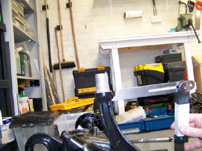

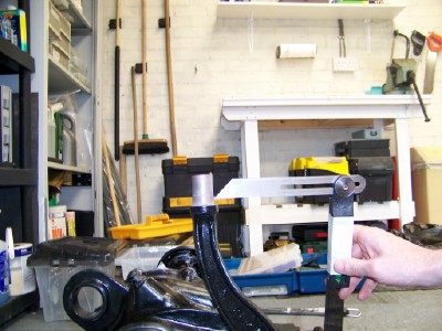

Firstly, I am looking at setting the distance “A” of the diff carrier at 158mm +/-1mm but am not sure where exactly to take the measure as fig 35-5/7 of the BBB shows the measure to the body of the carrier below the machine top locating portion whereas fig 35-5/8 shows the measure to the machined top portion itself. As mine shows a difference of over 1mm between the two possible measures could anyone let me know which is correct.

Figure 35-5/7 shows a reference line from front edge of the machine top extending down through the carrier arm.  I believe thios line is supposed to represent the same location as used in figure 35-5/8.  Any variance can be set when you check the alignment of the axle after mounting.
My understanding of the torque settings is the same.  I hope someone else can help.

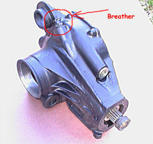

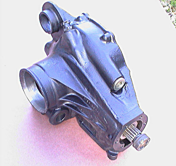

My 3,27 rear axle has plugs in place of the cooling tube ends.  There is no gear oil leaking from the breather outlet.  Is your breather located in the same place?

Where is the breather?
« Last Edit: June 01, 2008, 16:06:24 by naj »
« Reply #24 on: June 01, 2008, 16:17:57 »
The breather is circled in red.
Download Attachment: 327 breather.JPG
62.26 KB
I can't understand why it is leaking.  I'm sure the spinning gears kick up a lot of oil and splash it all around inside the diff case.  The gear oil is not otherwise under any pressure so as to defy gravity.  It must be the felt is too thin and what oil force is created by the spinning gears is sufficient to soak it through.
