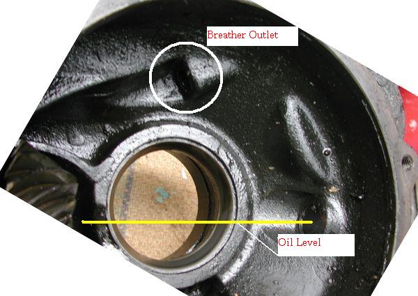

I wonder if its worth trying a different brand or spec of oil (after flushing)? I think your current oil may be foaming too much?
I just took some pictures of the diff casing. There is plenty of room in there and the crown wheel is turning CCW but the breather outlet is facing away from the oil spray...

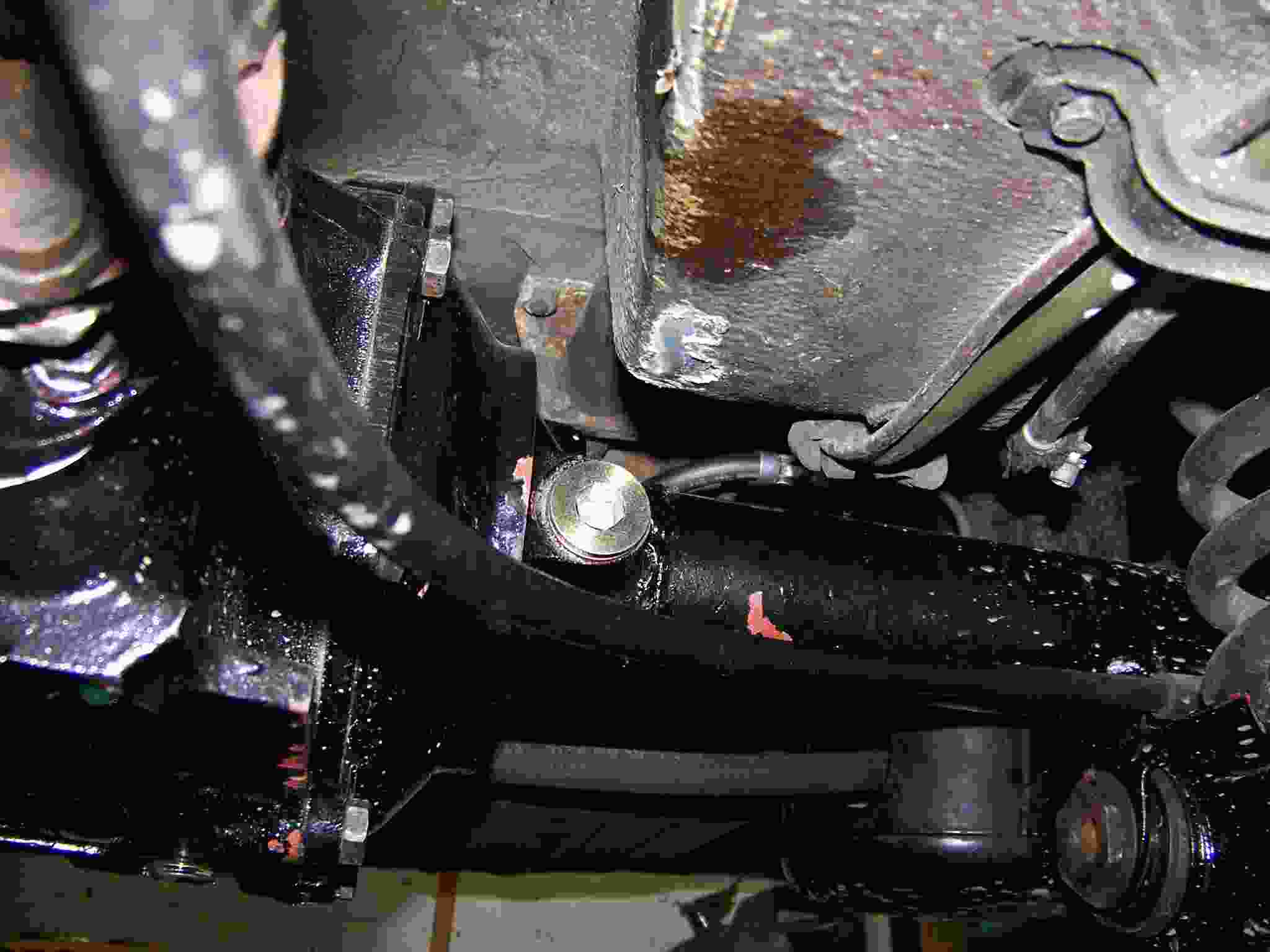

« Reply #31 on: June 12, 2008, 13:08:10 »

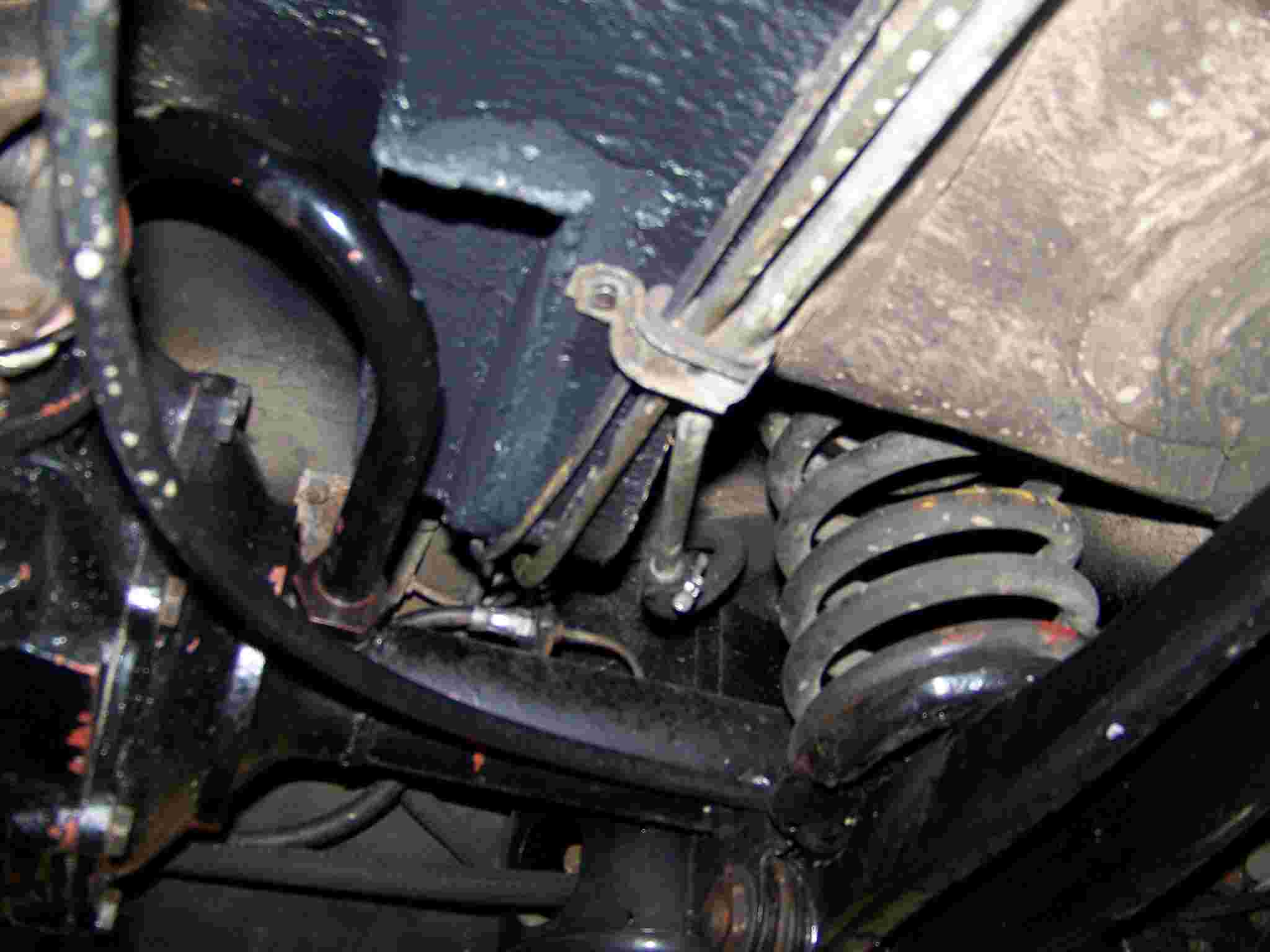

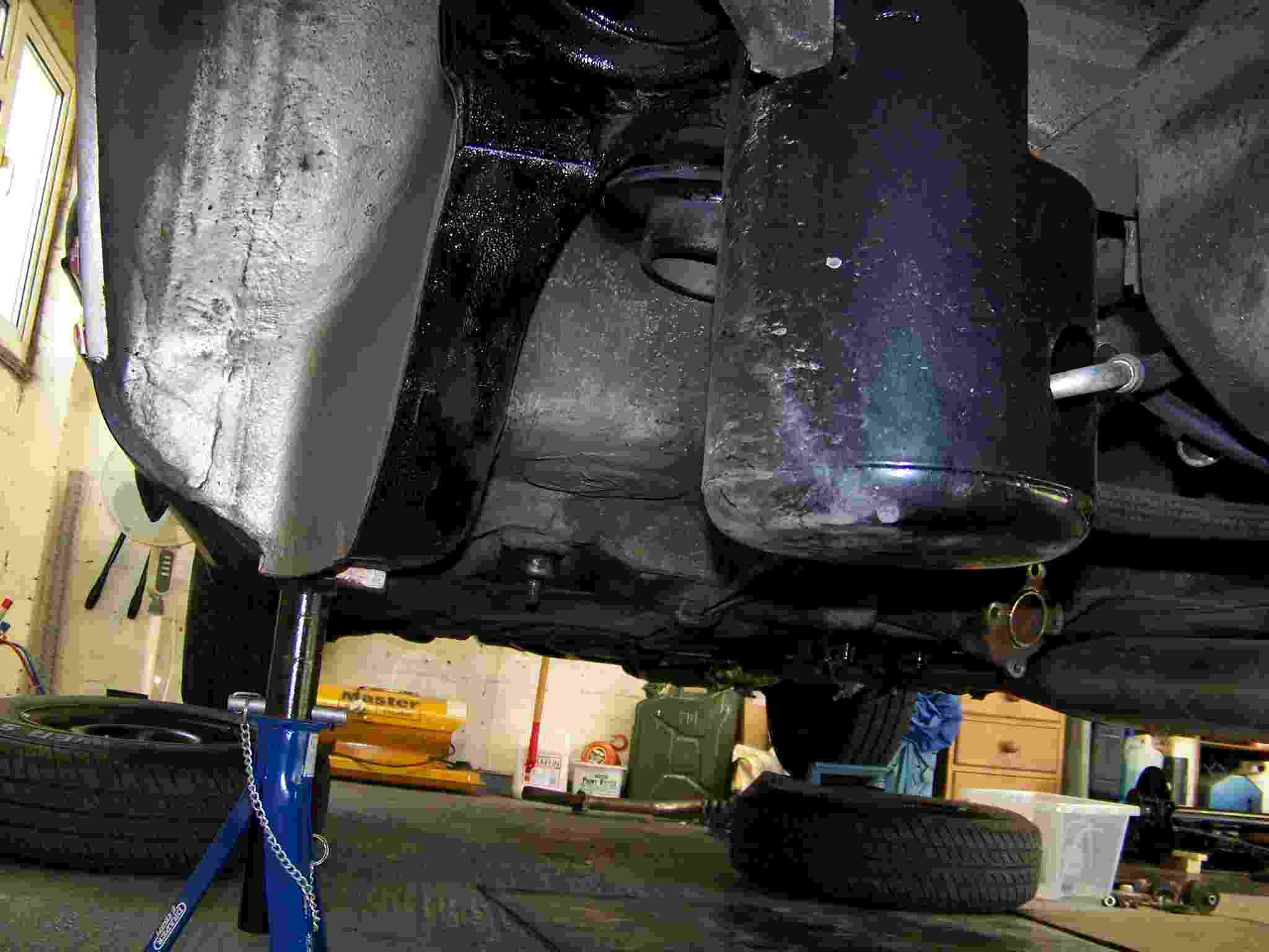

Here’s a few before photo’s, the area in question is the inside of the left hand chassis rail just after it curves forward, the square section of the corner needs to have a slight angle  to allow travel of the cooling pipe during suspension movement, it will actually fit whilst static but catches during suspension movement.
David Brough
1969 280SL Auto with A/C & 3.46 Axle (leaking)

DavidBrough
Re: 3.46 Rear Axle Rebuild
« Reply #32 on: June 21, 2008, 04:01:04 »

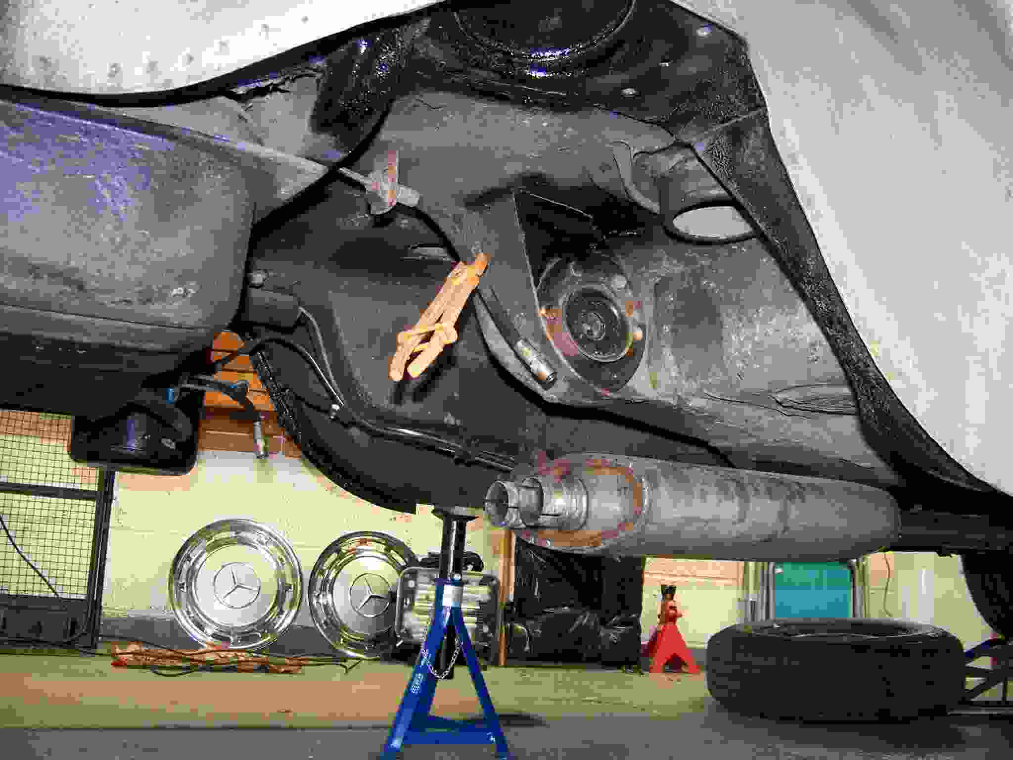

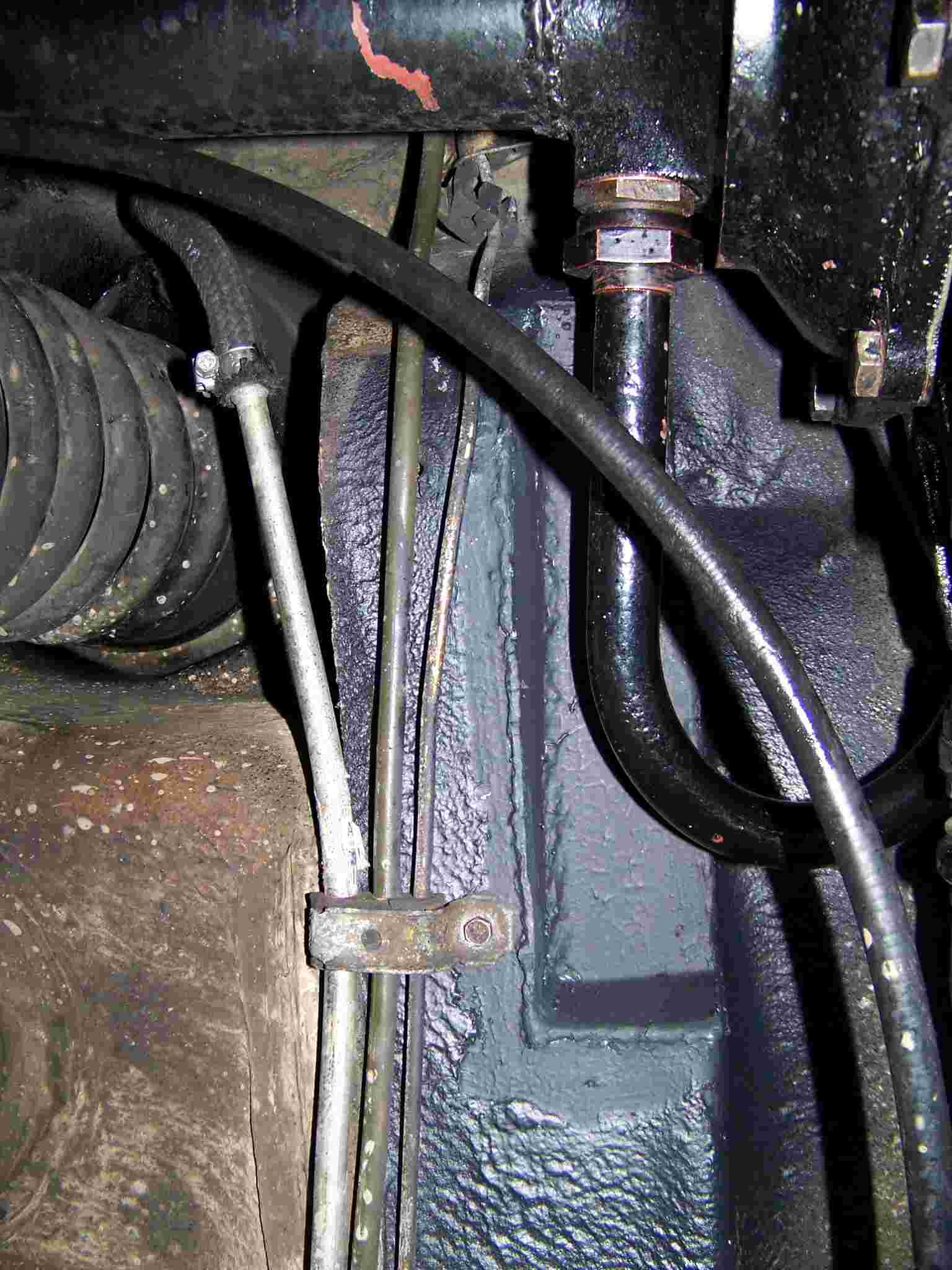

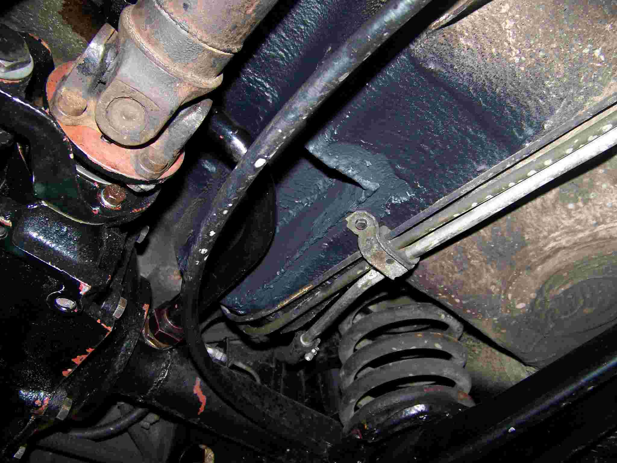

Success, axle oil leak now cured after fitting the large breather/cooling tube, pictures of chassis modification attached. Quite why it should leak in the first place is still a mystery but at least it’s cured now.
