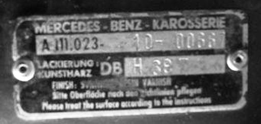

I have a 1964 built in 1963 number 671 230sl.  My paint and number plate is missing on the drivers side first and I am going to recreate it.
Should the first line read 113042-10
Second line                190 G  or G 190

This is the early style Body and Paint Number Plate, located on the driver's side A pillar. In the first line, the 113042 10 should be followed by the Aufbau (Body) number from the data card.
In the second line, I do not know if the G should come before or after the 190, our group member James Huber can tell you that, he has such an early 230SL with such a plate. The photo we have in our Technical Manual unfortunately does not have sufficient resolution to read it.

Here's the best close-up I could get. Klaus is correct that the right hand digits are the body number (Auf-bau Nummer stamped on hood, hardtop, etc). And the Paint manufacturer (Glasurit in my case) comes after the paint code.
Seeing how your car is only a couple hundred cars earlier than mine, I'd imagine the plates would be similar. I'm #871...

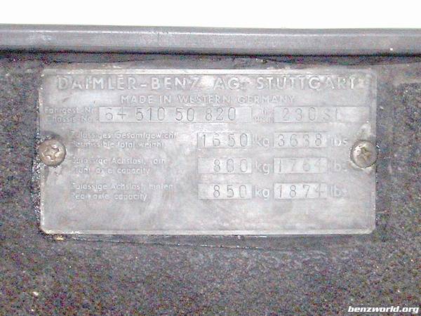

Bit off topic, but what does your 'other' plate look like?
Here's one I found earlier:

Hey Naj. Well, mine looks very similar to that. I tried to photograph it but the lighting combined with its faded condition, it did not come out.
Only difference is mine has my exact VIN 113042-12-etc, where yours seems to have the 64 510 etc. that doesn't look much like a 113 VIN. Is that maybe from a prototype?

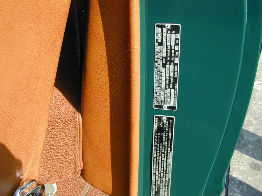

Ed,
I believe a late-model US-spec 280 SL would have those plates riveted into the body like this:

Thanks, you always have a picture as an answer !!!!

By the way, in response to JohnS, the "G" (for Glasurit) goes after the 190.
