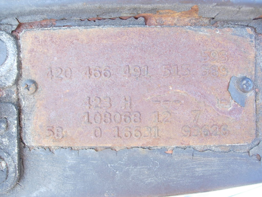

Has any one been able to take the data card (build sheet) which can be supplied by Mercedes Classic (refer to recent thread) and recreate the metal data card under the hood by the left side front shock tower.
I'm missing my metal tag. I would like to recreate a tag with the proper coding. I think I should be able to take it off the data card build sheet.
Here is is an example of a metal data tag (108 chassis) for reference along with the data card for my car.

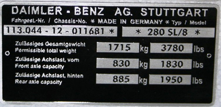

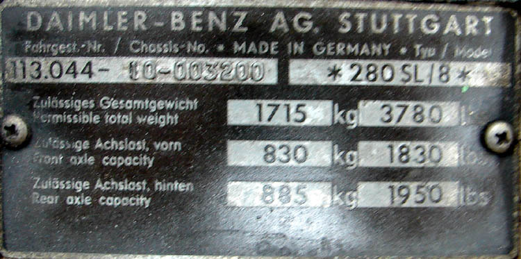

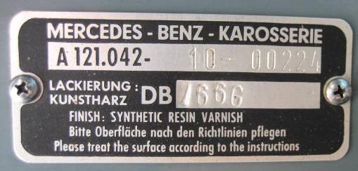

there is a guy on ebay that recreates them
ebayaupurchases@gmail.com
Download Attachment: 113.044 280SL.jpg
91.48 KB
Download Attachment: 113.044.Actual.jpg
94.68 KB
Download Attachment: IMG_3472.JPG
29.27 KB
paulr
lovely 1970 280 SL
Re: Data Plate missing by left shock tower
« Reply #2 on: March 10, 2008, 05:08:26 »
Looks like Paul and Pete are discussing two different plates...
Paul's looks like the plate on the passenger side (right side)of the Firewall of earlier cars and some later Euro cars...this plate is printed with information and has blank spaces to stamp the data about weight and seating capacity.
Peter's photo shows the plate attached to the top of the driver side (left side) fender...this is a blank embossed plate with no printed pattern. This plate shows major option codes, paint codes, job number, etc. but does not have weight or seating data.

This plate is described in detail in our Technical Manual, Data Cards and Codes, under "Body and Paint Number Plate".
In recreating this plate as accurate as possible, I would make it four lines:
420 493
670 H  670 H  6
113042 12   7
- 00591   03541

I think the data plate Peter is referring to is the one that tells the color codes. It is screwed on the inner left side fender. I think if you can get the information you need Peter, the Gentelman who reproduces the Vin plates could make you one and then you are set.
I think the first step is finding what information was supposed to be on that plate. Does anyone have any commment as a way to use the Data card of vin number to trace what Peter is missing?
