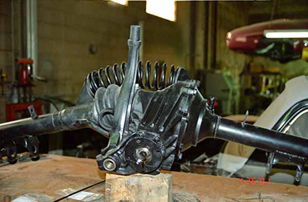

Just after re-assembly and before re-installation...
Download Attachment: Rear Axle and Differential on Bench Small.jpg
67.15 KB
...does this answer your question?

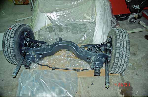

and in case you are asking about the front, again, after re-assembly and just before re-installation:
Download Attachment: Front Suspension Complete Small.jpg
73.31 KB

Hello Bob,
As you can see from Michael's photo the rear end can be removed with the spring in place. However as Jeff pointed out, be carefull when allowing the differential to hinge all the way downward. The thin casting  can be cracked by the slide joint inside.
