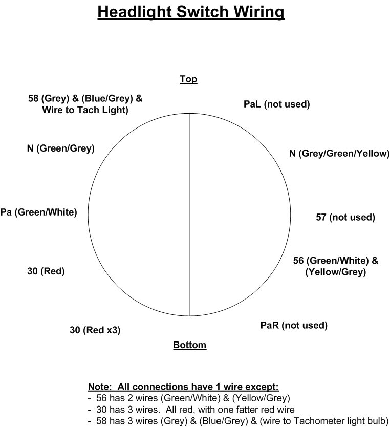

Where should the wire lead (power) for the Tach light connect to?  This appears to be the main power lead for all instrument lighting?
It looks like a PO ran a small wire from a connection directly connected to the headlight switch, postion #58.
Is this correct or should the instruments get their power from another location?  Current connect seems very odd.
Atached diagram shows how my current wiring connects to the back of the headlight switch...
Note: 3 wires connected to "58"...???

Can you get a copy of the wiring diagram (use Diagram in the search function, limit to general discussion, and title only). I got several hits, but could not read the diagram very well on the computer screen. It should be able to show you the connections, and they appear to be numbered the same as you show on your diagram. I am very curious to understand why the PaL and PaR are not hooked up. These should be for the left and right park lights, and would be expected to be in place. I have the diagrams printed at home and will check later. But I suspect there will be an asnwer posted before that.

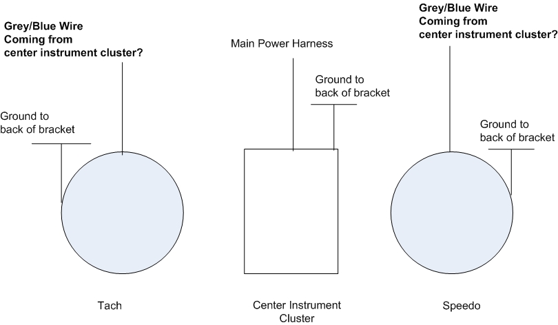

Please look at this diagram.  I believe this is correct?
Download Attachment: Instrumentwiring.jpg
73.17 KB
So I need to determine why the PO hooked the blue/grey (grey/blue) wire to the light switch?
The reason for this post and to ensure this is all connected properly is that I am installing a new headlight switch.  This weekend when I turned on my lights, I smelled something burning.  I quickly turned them off again.  Got home and pulled the Tach out and also the light switch.  With switch removed, turned it back on in order to trace the issue.  Switch got very hot.  Earlier post from Dan indicated the switch is bad if it gets hot.  What's also odd is that when I temporarily hooked everything back up again in order to drive the car (daytimes...), when I turn the headlight switch to the very first position to the right, it quickly blows fuse #7.
So, I want to ensure that with the new switch, all is hooked up as it should be.
Thanks for your help!

the terminal 58 connection that the panel lamps are tapped into is a circuit that is not fused. The correcc wire that goes to the speedometer, comes out of the wiring where the ignition switch wires come out of the main harness, I dont recall where wire for the tach pops out of the main harness, and the center cluster is wired through the plug in connector to the left of the steering column.
The switch heating up can be a symptom of a defective switch but it also can be the result of miswiring and there could possibily be other circuits that have been improperly jumpered and are not protected by fuses.
It sounds like it is time to start from scratch disconnect everything that is connected to the lighting circuits, and test to make sure they are connected correctly through a fused circuit before puting everything back to gether.

What I will do is make sure to only hook up the "grey" wire onto connection "58", as shown on the wiring diagram.
I am hoping that the blue/grey that was hooked up to "58" is the wire that is supposed to go directly to the Tach light. I will go slow...

Can't say about the wire colors because I don't have that detail. But going by the wiring diagram in the BBB,  power for all dash lamps feeds through the dimmer rheostat.  You already know this rheostat gets its feed from fuse #7.  Fuse #7 is connected to terminal #58 on the headlight switch.
Any dash lamp should be fused.  If the PO bypassed fuse #7 and connected terminal #58 to the tach lamp feed this circuit would bypass the fuse and rheostat.

By removing all dash instruments, including the headlight switch, I found that a previous owner ran a small black “patch” wire from the Tach light directly to position "58" on the headlight switch (this by-passed fuse #7).  The previous owner also ran the grey/blue wire that comes out from the same bundle of wires that connects to the headlight switch to position “58” on the switch.  Also installed on position “58” was a solid grey colored wire.
To be safe, I installed a new headlight switch and only connected the solid grey colored wire to position “58”, as per the wiring diagram.  I completely discarded the small black “patch” wire.  I connected the grey/blue wire to the back of one of the Tach lights.  Note: wiring diagram shows grey/blue colored wires for the dash lighting.
