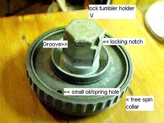

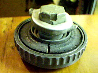

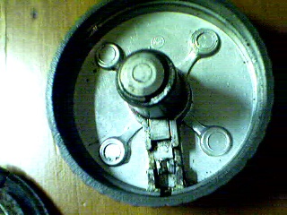

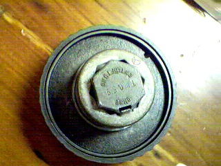

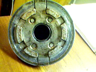

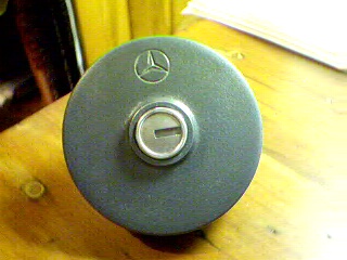

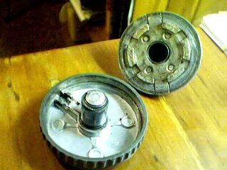

Hi DB and Achim,
I hope these pics help.
I bought this sedan lock with a key for $15.00. Later I bought a 113 chrome locking cap with NO key for $100.00.
I swapped the tumblers over. It was tricky because I needed to swap the chrome escutcheon over too and behind the chrome escutcheon where the key enters there is a very small spring which can be easily lost.
Something to know.... You should insert the key in the tumbler when you remove it from the cap. This will prevent the 'pins?' inside that the key operates from falling out.
Also the tumbler comes out from the front.
Download Attachment: LockFuelCap_10.JPG
