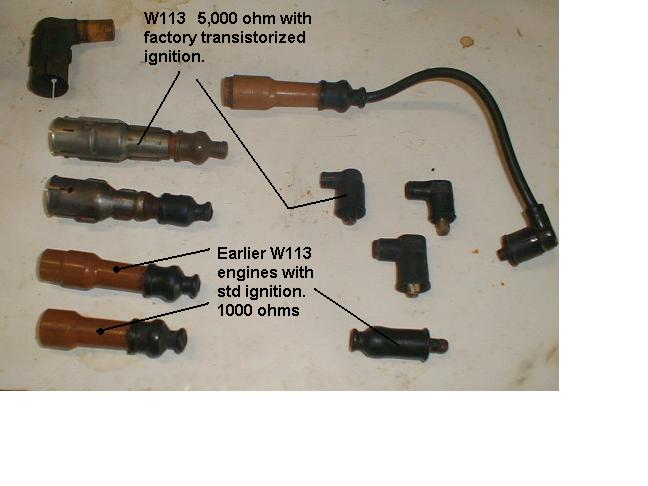

The early W113 cars without the factory electronic ignition used the non-shielded 1,000 ohms spark plug ends #000 159 3210 and are often refered to as "far range".
The later W113 ignitions with the metal shielded spark plug ends "close range" #000 156 3010, #000 156 3210 were 5,000 ohms. I believe these were used on the later W113 cars with the factory electronic ignitions?
All the factroy wire sets used solid stranded copper wire which was tin coated  #110 159 1818 (by the meter). This was very good stuff and would not fail unless the insulation is shot. The wires misfire when the resistor ends go bad causing too much resistance, then the spark cannot get through or jumps and shorts causing a miss. Many original cars are still using the good factory original wire set after 40 years!  The wire resistance can be checked and the bad spark plug wire ends can be replaced (they screw off if the set is original). You use to be able to order new original wire by the meter (above) and "build a new set using your good ends and boots. Do not throw your originals away. Chances are you will never get set built and fitted as well.
Most of these cars have had the original ignition combinations scrambled up. If you have a standard ignition and your car is eating up points you may have a bad combination of coil and/or ballast resistor.

Here are some original ends;
Download Attachment: ignition.JPG
