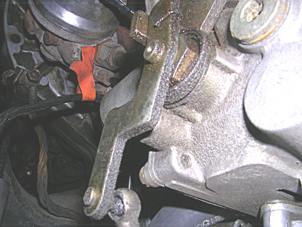

let's not discuss who I got here.......?? let's just say I need help badly...
I have disonnected the throudle control on the side of the pump and
now I am way out of adjustment???? the spring is off the whole thing
is a mess. I have no one to help, except a haynes manual.
Please help. I need to get this arm back on and the shaft it rides on
in the correct position.
Help Jim

Jim,
Sorry to hear about your trouble.  Here are some pics I took of my car. I hope they help.  I've not taken the linkage off the pump myself but I'll be happy to help all I can.
Good luck
Download Attachment: linkage1.jpg
66.4 KB

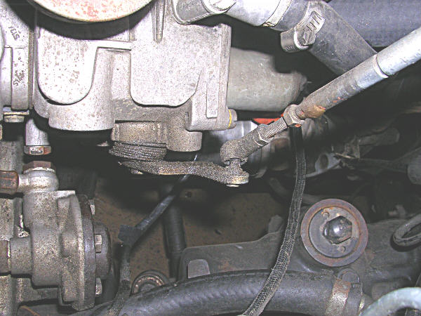

« Reply #2 on: August 19, 2007, 15:55:59 »
Download Attachment: linkage2.jpg
63.43 KB

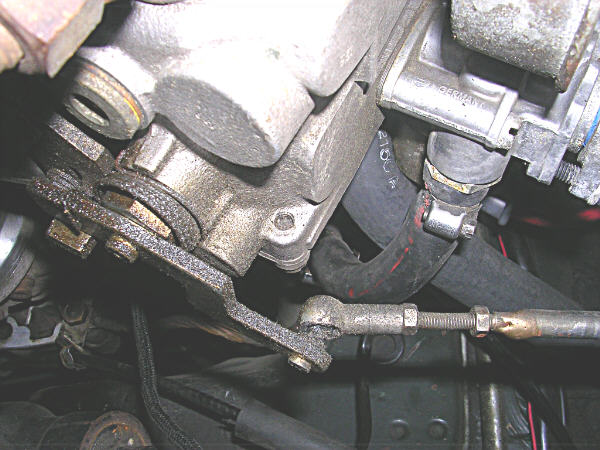

« Reply #3 on: August 19, 2007, 15:56:30 »
Download Attachment: linkage3.jpg
62.31 KB

« Reply #4 on: August 19, 2007, 16:10:10 »
I am affraid I did not make myself clear. the arm that is attached to the shaft, going into the pump (like the one's you have taken photo's of) is off? and how do I determaine how to set the correct postion to attach it. and how do I know how to put this shaft back into the correct position?
Jim
