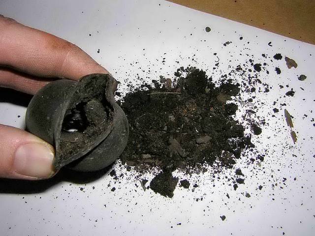

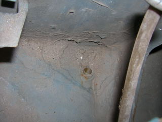

Thanks for the posts about the blocked drainage tubes. Today I set about trying to find, then unblock them.
I used a wire coat hanger to check the tubes. The right hand tube (as you face direction of travel), the more accessible one, had no rubber ball, which threw me for a while. Once found (at the end of my nose) I inserted a wire a long way up the tube and it did not seem blocked.
The situation was somewhat different for the left hand one. (See attached 'photos for a laugh). The ball was present and the attached photograph might serve to give an idea of what said ball contained. (Most of a forrest; I think I will use the contents as compost for my orchids). The ball was completely perished and the drainage tube well rusted, but not irreparable. I was hoping that lots of water would flood out as I unblocked the tube but none did. That said, today was the first day that the foot well was dry.

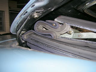

I am also looking forward to taking the top down for the first time tomorrow to see about the drainage holes in the hood space.

  The tubes from the scuttle box can clog, then water will no longer drain from the scuttle box. At that point the scuttle box overflows and everything rusts. James could have been getting water into his car because the tubes were blocked or because the metal drains have a section os ruber hose in them. If the rubber hose breaks draining water will leak into the interior of the car. The sloshing James heard could be from water which overflowed from the scuttle box or it could have been water in the heater core. I would check the ruber hoses and if the inside of the car stays dry I would suggest you leave the heater core alone for now.

Yes that's correct, the tubes exit the scuttle box, then switch to rubber then back to metal that travels through the firewall crossmember to exit in the engine bay. If the blockage occurs past the rubber hoses then the metal tubes that pass through the crossmember can rust out and fill up the crossmember with water which has no place to escape until it rusts through. If James is hearing water slosh when rocking the car, this can't be the heater core...the passage ways in the core itself are too small to create a sloshing sound and it would mean the cooling system was low enough to allow sloshing....I doubt very much it could be heard outside of the car either. I suspect that the water is in the crossmember and even if the tubes seem to be OK, it would be very difficult to tell if there was a small rust hole where it passes through the crossmember. These metal tubes would be approx. 6-8" long and there is no way you can see inside of them. From James description of the debris in the rubber ball, I would guess they have been blocked long enough to rust through the tube and likely this is where the rust in the floor comes from as the support member that runs below the firewall crossmember will also fill up with water which eventually rusts through into the footwells.

If the water is just in the crossmember and has not migrated into the box section running down under the floor, then I would say yes you need to drill a hole somewhere. In my case the rust had eaten away at the area around the pass. side drain tube itself. Initially all I was aware of, was a small dime sized area of rust under the tube where it exits the firewall, so perhaps this is close to the lowest spot, though truthfully the crossmember is pretty level across the car and if you are going to drill a hole, probably any convienient location along the bottom edge would suffice to at least drain the section. Now that you have cleaned/removed the ball fitting any new water will be inclined to flow out where it's supposed to, but there is likely a rust hole in that tube so additional water may get into the crossmember again. If you determine that things have not deteriorated too far then I might consider trying to insert a smaller diameter tube through the existing one and adapting under the dash so as to avoid having to replace the current rusted tube. These are actually welded to the inner and outer skins of the crossmember so removal is difficult. In my case a little digging around the initial rust spot revealed that the rust was much more extensive than it first appeared and I ended up doing major surgery, replacing the whole crossmember and some of the floor area on the passenger side. I was only able to do this because I had the engine out of the car. The box section running under the floor is of a thicker gauge than the crossmember so I was able to salvage it, though it had rusted through to the interior floor area. After all the welding was finished I injected undercoating into the crossmember and box sections to slow any further oxidation of the surfaces I couldn't replace.
The most discouraging aspect of this job was the fact that I had been shown the rust area under the drain tube by the previous owner, who stated that it was the only rust he was aware of and I told myself "that's no big deal" and only discovered a couple of years later, that it was a much bigger issue than it had appeared.
Still it's all fixable.... I purchased a new crossmember from K&K, though it was an OEM part anyway, at reasonable cost and my son and I had a great bonding experience making the repairs. It helps that he's a mechanical engineer with a machinist certificate and wrote his thesis on new welding techniques, but only a little  :)
Don't be discouraged...it's all part of the mystique of owning these lovely little gems and the thrill of driving them makes it all worth while. At least all the parts are available.

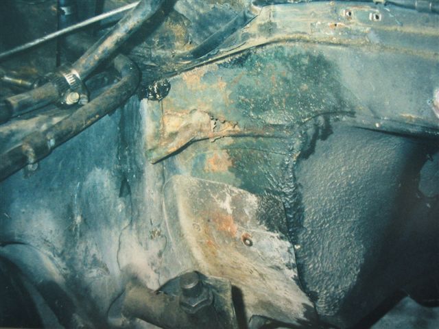

I used the advice given earlier and on hours of searches throughout the site to track the route of water that enters the area of the firewall. The drivers side was easy (I just had to look up) and I removed the cardboard panels on the passenger side to expose the pipes. The photos show what I found:
Download Attachment: Coroded drainage tube dvr side.jpg
37.48 KB
Download Attachment: Pass side drainage tube.jpg
30.63 KB
As you can see, the passengers side was fine perfect (it is also the very dry side of the car) and a highlight of the day was finding what to the untrained eye appears to be some of the original firewall pad (yes??) - anyway, it cheered me greatly. The drivers side, however, was utterly shot. It was also blocked with fluff amongst other things (small woodland creatures, light aircraft, etc) and so I can't imagine - given the amount of water in the drivers side footwell - that the water came in through that route. I say that because I then went on to remove the air scoop (I'll throw in scuttlebox to help others' searches) and found that the area was dry; almost dusty. I have attached 2 not great photos of the drainage holes in the firewall:
Download Attachment: dvrs side firewall drainage hole.jpg
36.47 KB
Download Attachment: pass side firewall drainage hole.jpg
29.51 KB

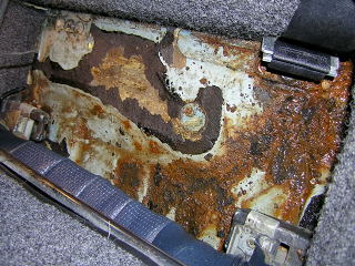

To reiterate, the firewall was not wet. I am therefore still at a bit of a loss as to quite how so much water entered the car. At some stage during the day, I put my hand behind the drivers seat and was rewarded with a wet palm. I had stupidly forgotten to check the rear of the seat. This is what I found:
Download Attachment: Dvrs side floor panel behind seat.jpg
76.37 KB
This was a low point, but hardly unexpected. It's all got to be replaced anyway.

There are a few of us here with "known" floor issues and obviously the floors are usually the worst, as effort is spent keeping the exterior looking good, floors are ignored. Some of us even live with sub-par floors, planning to some day get around to it, but still catching all the smiles over all those miles (about 25,000 in 6 years).....the parts are all available, including patch and repair panels...it's just steel
Congradulations on taking the plunge....I envy you because I remember how the first few weeks were such a heady time...mostly exciting and only occasionally discouraging, a bit like falling in love  ;)
I'll pass on the invite to Nigel, but I suspect he'd rather stay in his new home with his new 2 month old daughter and have his family come stay with him for christmas  :D
Download Attachment: SL rust repairs 015.jpg
65.77 KB
Download Attachment: SL rust repairs 016.jpg
63.06 KB
Download Attachment: SL rust repairs 017.jpg
72.46 KB
Re: TUV Test Failed - update and progress
« Reply #20 on: December 21, 2006, 20:18:27 »
Hey James
Have you looked in the space under the shelf behind the seats?
If the rear seals to the top leak it is possible that water could enter though the soft top well area.
Maybe a quick look under the rubber mat in the boot too.

« Reply #21 on: December 22, 2006, 05:45:57 »
Thanks for your post - I went down to the car today specifically to identify where from where the water comes. The car only has a soft top, which I have not yet touched and having read many many threads here about tops getting stuck, I am glad I resisted the temptation to put it down - I have no doubt I would have got it truly stuck. Anyway, I removed the wooden floor panels expecting the worst but they are bone dry and show no signs of ever having been wet - not lately at least. (I am happy about this). I then felt the next place to examine was the soft top box. I WD-40'd the hinges and joints yesterday in preparation as I have no idea when it was last lowered. Today I pulled on the handle and lo - it's not connected to anything! It just merrily swings about.
I had a look through the rear of the trunk and can see that the bolt on the end of the lever seems almost off its thread. I've searched on the site and have found this post:
http://index.php?topic=5681,top,release,broken
I will try to move the latch in the centre of the box over tomorrow. (Grateful if anyone else has any ideas!)
So, the search has come to a halt as I could not continue until I'd searched this most excellent site for what to do about the release lever. And I found the info here. Tomorrow I'll give it a go.
BTW, the rear license plate problem was nothing more complicated than a broken bulb! (Although both of the glass covers are shattered, which seems odd - I'll add those to the list).

« Reply #23 on: December 22, 2006, 09:59:39 »
I can share another useful place to look for rust. Remove the kick panels and take a peek in there. You can usually spot trouble in the sill/front rocker area.

« Reply #24 on: December 23, 2006, 12:13:47 »

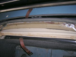

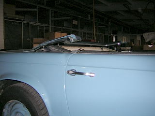

Todays main effort was to free the soft top box cover, which I managed to do with the loss of only 3 fingers, a socket and my sense of humour (twice). The directions on this site on pushing the bolt of the release mechanism to the drivers side using a screw driver put through the acccess hole in the soft top box worked very well. However, I then had to hook some strong polytwine around the mechanism and pull VERY VERY hard to release the side latches. I have now fixed the release lever and have used a split washer to prevent a reoccurance. I have also made the poly twine a permanent feature - just in case.
Once inside the soft top box, all seemed immaculate. I found the drainage holes and gave them a run through. I then injected some water into each to see where the water flowed. It dripped out from the sills (rocker panels) by the rear jacking point. No water came into the footwell of the car. This is good as it means that the drainage tubes are reasonably fuctionable at least. But, I am no where nearer finding out where the water come from (I can't believe that the water entered through the floor, although there are numerous holes in there miss their gromets, etc. Unless it rains from the floor up in the US and whilst on ships to Europe. Or it came in through the roof, about which...)
Having finally released the hood, I felt it was time to try and fold it into the soft top box. Again, I read all the threads I could find and there was much good advice about using belts. (See photos below - I will spare you the one of me, trousers at ankles).
The hood folds OK, but I cannot get to a point where I could reasonably get it into the soft top box with a view to closing the cover. I've read the threads about CPR maneuvers and I take Tom's point that these cars were designed by Ze Germans and so we shouldn't need to stand on the cover to close it. I have therefore posted a few photos of my hold in the as-good-as-folded position in the hope that some kind fellow can spot the obvious mistake I'm making. FYI, the hood is made by Kal-Glass (no idea whether they're any good or not) and has numerous rips to the right top where it has caught in the frame a lot - almost one rip per bow. Please tell me what I'm doing wrong or how I can get a quart into a pint pot!
I also have to repair the tears as a new roof is not in the budget. Do I need to get the repair vulcanized, as the roof seems to be made of a canvas-type material?
Download Attachment: roof fold 1.jpg
