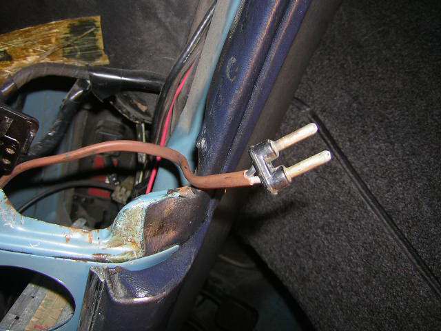

I found this cable in behind my glove compartment. Can anyone please tell me what it is for? (My cigar lighter doesn't work - could this have something to do with it?)

Radio??

Glennard, thanks for the suggestion, but no. The radio works fine without it. So does the clock and the other dash instruments, less the speedo but that's another yet to be addressed problem.
Download Attachment: wire.jpg
77.64 KB
Does your Glove box light work?

It did. I haven't checked it since I took out the glove box and put it back in but the cable carrying current to the bulb connects on my car via a screw terminal and not a plug so I am pretty certain that isn't it.
I wondered if it had a/c once? Could it be for that?

Looks like the plug in power to the original radio(Becker/Blaup-??).  Do you have a replacement radio?  One of those plug is hot, if it is still connected.  The other is ground.
