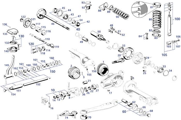

As I am searching for a 1:3.27 diff I thought I'd trawl SLS's pages to see what they offer.  From what I can see, and from little I understand, I think that their page shows some gears that look like a replacement for the original ones that seem to give the 1:3,27 ratio. I've attached a photo. Look at part 20. When one clicks on that part you are taken to the detail page which shows a variable from the 1:4,08 to the 1:3,27.
It may be necessary to go to their webpage to see what I mean (link below) but is it possible to have a set of different 'bits' that one can fit into the original housing and get different gearing?
If so, is it just a case of purchasing the new parts at the desired ratio and fitting them, he asks, expecting the answer 'no.'

Re: 3,27 axle checkout, reseal, repair & install
« Reply #72 on: February 01, 2008, 15:51:43 »
Originally posted by Buz
Are there any ring and pinions between the 3.92 abd the 3.27 that fit a w113?  I think a 3.27 is too tall for an automatic starting in 2nd gear.
Yes:
3.75 on some early 230SLs
3.69 diff casing???
3.46 The diff casing is bigger too
