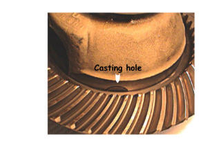

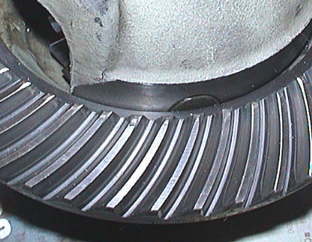

This is a picture of the diff casting and ring gear.  Joe has advised us to be mindfull of an elongation in the casting that can take place in high mileage rear axles.  You can see from this picture that the casting hole is round and the gear shaft fit is snug.  Will post more pics as I can.
Download Attachment: OH Casting1.jpg
15.85 KB

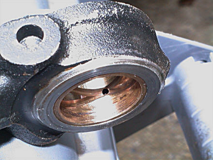

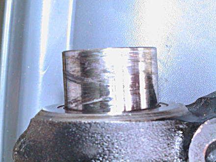

Thought I would post a couple more pictures of the swing axle.  You are looking at the hinge assembly and bushing for the swing axle.  Note the X channel and hole in the assembly.  The X channel helps distribute grease throughout the connection. There is a hollow space behind the brass bushing that is connected to a grease fitting.  As grease is pumped in the X channel helps force it out to needed locations.  It's hard to see but this joint was dry at one point and there is some scoring on the bushing and axle assembly.
Download Attachment: swing hinge bushing.jpg
35.92 KB
Download Attachment: swing hinge.jpg
38.01 KB

Here is a better pic of the casting and hole for the spider gear shaft.  In my case the hole was in great shape.  Hope this is what you were looking for.
Download Attachment: OH castingb.jpg
44.29 KB

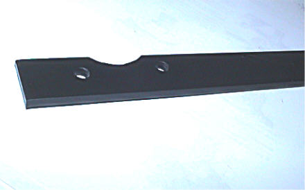

Had to make a couple of tools for the axle.  A tool is needed to tighten the slotted nut on the axle shaft after the bearing is pressed on.  I welded this tool together using a 1 1/2 inch steel pipe as the starting point.  Two pins were added to fit into the slots and not shown in the picture is a 3/8 square fitting on the bar for my torque wrench.  I need to apply 150 ftlb of torque to secure the nut.
The second tool is simple and is needed to hold the pinion shaft secure while torquing the pinion nut into place.  The bar is bolted into place using holes in the flange.
Download Attachment: pinion nut bar.jpg
12.66 KB

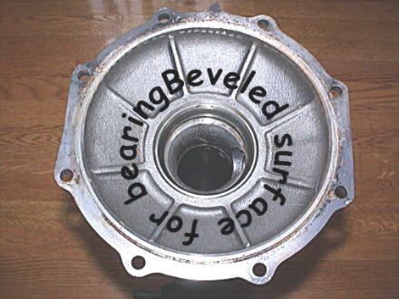

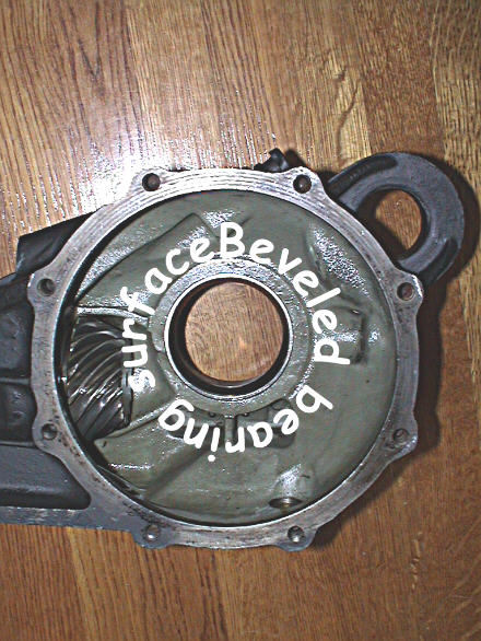

Here are 3 more pics.  They include the diff case, fixed axle shaft and ring gear assembly.  Each side of the ring gear assembly has a tappered bearing pressed on.  These bearings mate with a beveled surface in the diff case and fixed axle as the axle is bolted to the diff case.
Download Attachment: diff case bearing surface.jpg
79.51 KB
« Last Edit: October 16, 2006, 15:41:27 by jeffc280sl »
Re: 3,27 axle checkout, reseal, repair & install
« Reply #16 on: October 16, 2006, 12:35:42 »
Download Attachment: Diff case w-ring gear.jpg
46.12 KB
Download Attachment: fixed axle bearing surface.jpg
39.99 KB

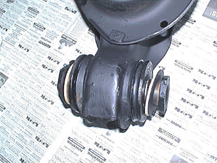

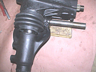

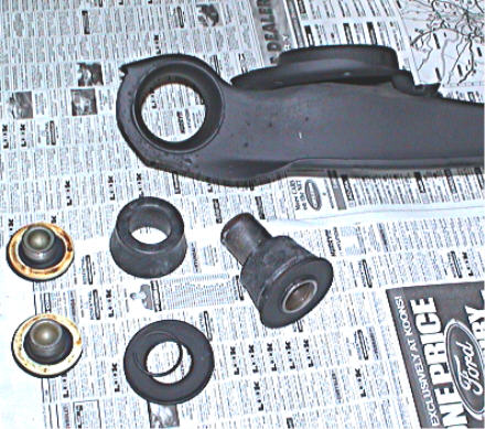

As I reassemble the 3.27 rear axle I thought I'd take some more pics to document oil seal and rubber bushing replacements.  These pics show the trailing arm bushings going in.
Download Attachment: trailing arm bushing.jpg
60.86 KB
Download Attachment: trailing arm complete.jpg
45.53 KB

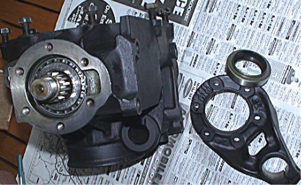

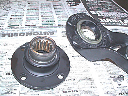

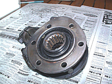

Here are some pics of the pinion gear shaft oil seal going in place.  I've taken pics from different angles so that you can see the detail.  Pay particular interest to the raised metal lip on the oil seal.  The drive shaft mounting bracket is the actual part that is sealed by this oil seal.  This bracket has a neat dirt and debre cone which extends over the metal oil seal lip to keep it protected from road grime etc.  It is a very neat design that I hope everyone can see clearly.
Download Attachment: pinion seal underside.jpg
54.34 KB
« Reply #20 on: October 19, 2006, 14:27:33 »
More pinion shaft seal pics.
Download Attachment: pinion seal install.jpg
51.34 KB
Download Attachment: Pinion seal.jpg
42.49 KB

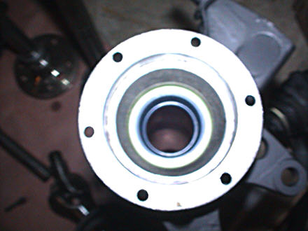

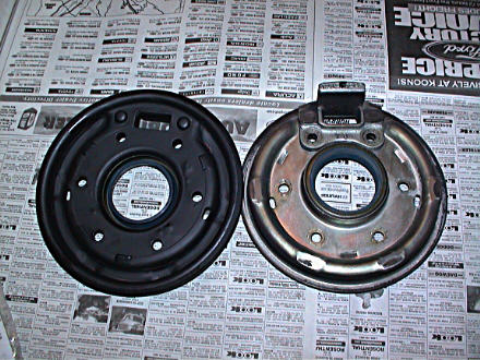

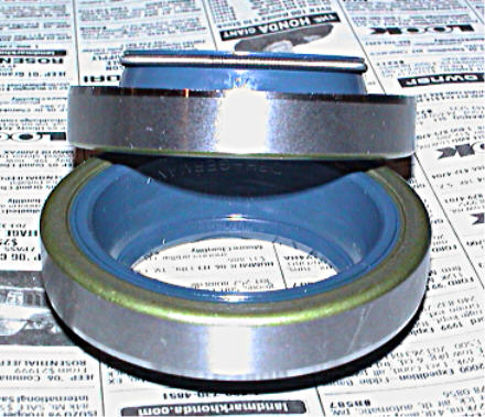

Last pics for the evening.  Note the inner seal and the extended base for good oil seal inside the axle tubes.  The last picture is of the installed outer grease seal.
Download Attachment: inner seal.jpg
51.43 KB
Download Attachment: inner seal complete.jpg
26.18 KB
Download Attachment: outer seal complete.jpg
58.14 KB

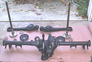

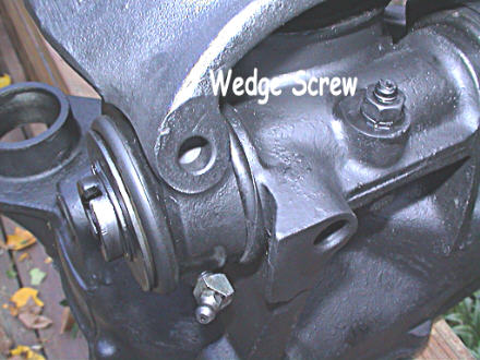

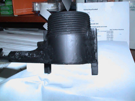

« Reply #22 on: October 21, 2006, 09:57:50 »

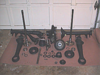

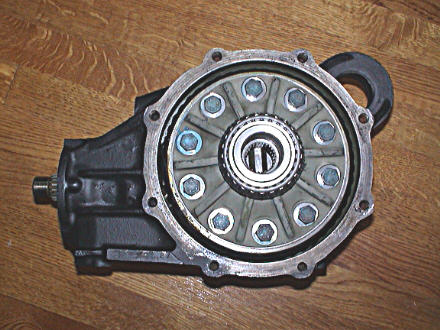

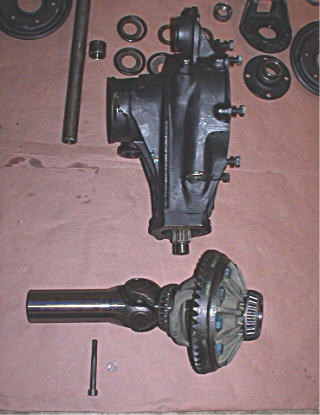

Spent a couple of hours this morning putting the rear axle housing and differential back together.  Need to align the carrier, preload the pinion, press bearings on axles, install axles,  brakes, trailing arms and put oil in the diff case and that should about do it.  Here are some more pics.
Download Attachment: axle parts.jpg
15.51 KB
Download Attachment: conn bolt & wedge screw.jpg
39.14 KB
Download Attachment: diff case and right uni.jpg
29.2 KB
Download Attachment: conn bolt.jpg
17.28 KB
Download Attachment: assembled diff.jpg
19.5 KB
