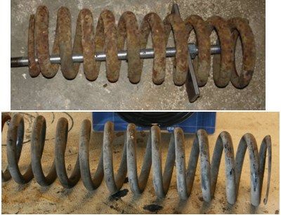

Way, way back in the day, There used to be a spring kit for the 108 sedans that was sold by Benz as a lower cost replacement option for the hydro-pneumatic compensator. I only mention this because I remember it only taking about 20 minutes for me to install one of these kits. So I thought it would be no big deal to drop down the center compensator spring, install a thicker spring pad against the axle, and swing up the bracket with a pair of big channel locks and a prybar The way I used to do it and I would be done in about an hour.
Well that didn't happen.
The 113 compensator spring is a smaller wire diameter and longer uncompressed length than that 108 sedan spring, in fact so much longer that I couldn't even fit the spring onto the bracket with one bolt out and the bracket rotated as far as it would go. I ended up having to fabricate a spring compressor out of an 1/2" all-thread rod and a couple pieces of 3/16 X 1" strap. When I first tried the compressor, the spring arched the wrong way, so I had to back the nut all the way off and make a hook at the bracket end of the spring, I compressed the spring all the way down again and this time the angle of the axle casting was holding the spring too far off center, so I had to back the compressor all the way off again, (I was only able to turn the wrech on the nut 1/12 of a turn at a time) I then had to make the compressor strap on the axle end short enough to fit flat into the recessed area of the axle casting (Where the hydro penumatic compensator's bushing would go). This time (finaly!!) every thing lined up just right and it all bolted together without having to force any thing.
The result, by installing a 3/4" thick spring pad I was able to raise the rear end by 1/2" measued at the wheel arch over the center of the hub cap Star. Now with a spirit level on the trim line of the door moulding it's just slightly higher at the rear with the tank full and the hard top on. Before it was drooping down in the rear.
I am not pleased enough with these results to reccomened this procedure to others, when I have time I will install the proper oversized pads on the rear springs to get the correct height, but for now it's O.K.

By the way, a few years ago I too fabricated a compressor for the compensating spring using a threaded rod and some plates. I've since re-used it on three other rear axles with relative ease. Details can be found at http://sl113.org/forums/index.php?topic=1642&whichpage=2. Needless to say, I'm very pleased with it.

The spring shown in Waquas' earlier thread looks to me like the shorter fatter spring from a 111 sedan.
Download Attachment: comp springs.jpg
39.72 KB
I took a picture of my sl's spring, it still has the 113 part number visible on it, and resized the two images to the same scale. The top spring is from Waquas' thread, the lower is the spring from my SL.
As I mentioned in my post the shoter fatter spring was fairly easy to lever (I think my being 20 years old at that time factored into the equation) into place without a spring compressor, but the 113 spring is much too long to get into place without using a spring compressor.
Al Lieffring

Interesting... so I have a sedan spring in my Pagoda. (Al, can you please post your original part number?)
Question: wouldn't the fatter spring be stiffer than the thinner one, assuming they are composed of similar materials? And shouldn't the SL spring be stiffer than the sedan one? Why or why not?
Waqas in Austin, Texas
I still got my Sunday go to meeting colthes on, so I cant crawl under there right now, I will look for you when I get a chance.
As for the engeneering advantage of one spring design for the sedan as opposed to the other for the roadster, I realy don't know why a short strong spring for a sedan and a weaker spring under more tension for the roadster was chosen, but the unloaded sedan of course has more weight over the rear axle, and it also has to function over a greater range of loading conditions with a larger trunk and 0-3 passengers in the rear.
Al Lieffring
