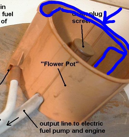

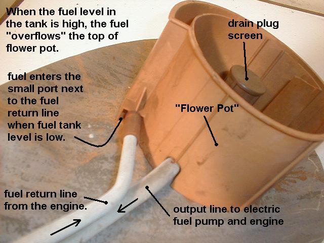

Hello Al,
You are literally running out of fuel when the fuel level in the tank becomes lower than the top rim of the "flower pot".  Most likely the intake port of the flower pot is blocked with crud.
You can drain the tank, remove the fuel sender in the trunk and use a wire to clear the intake port in the "flower pot". After all the fuel is safely drained and stored, the tank can be flushed. You can use compressed air and a long nozzle to clear the port, working through the fuel sender opening. Be cautious around the gas fumes. Best to work outdoors in a well ventilated area. Contaminatd fuel or water should be disposed of properly and safely.
If you drain and dry the tank before you begin you should not generate much or any waste. Fuel can be strained, filtered and reused.

Merry Christmas Al,
Once the tank was emptied I took a LED flashlight and looking through the float sensor hole found that there was a buildup of crud in the outer ring of the flower pot
The crud may be coming from the inside of the fuel return line. May be worth checking/replacing.
I used an old outer heater cable thru the return line to clean the area marked in your picture. Works well.

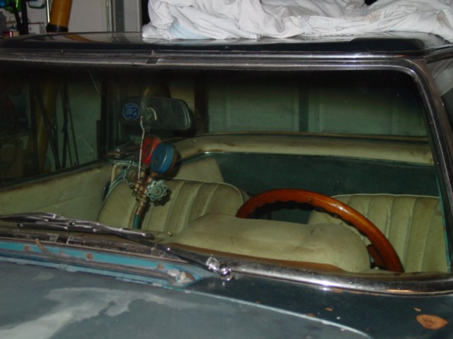

Next test I  removed the fuel pump fuse and ran a jumper to the #3 fuse tab through an ammeter to the battery (+). I left the pump running for most of the afternon (with a small charger attached to keep the battery from running down). The pump drew 4.6 amps with no change as it ran for about 3 hours (circulating through the fuel loop with the motor not running). I checked the pump volume at the return line from the pressure damper on the motor mount arm, and it pumped out a litre of fuel in about 15 seconds.
I then made an adapter to attach a pressure gage at the CSV fitting and the pump was producing about 12psi, and again I left the pump circulating fuel as the car sat in the garage with no drop in the pressure for over an hour. I re-checked the main filter, the tank screen and the inlet screen on the pump a few flecks of junk but not enough to make the car stall, I blew compressed air through all the lines. I disconected the PerTronic Ignition and reinstalled the points, condensor, and black Bosch coil because an intremittant HEI can also give similar symptoms.
With a fuel pressure hose running through the one of Kuhlmeister dash holes to the gage hanging from the rear view mirror I took the car out for a drive.
The same symptoms as before, the car drove for about 20 minutes, the fuel pressure slowly dropped to 0 and the car eventualy stalled. I turned off the ignition and turned it back on. The pressure came back up for about 10 more miles, the motor stalls again, with the gage showing 0 I check the voltage at the pump and have 11.5 volts. I get back home and try installing my late style pump. I had to install a T fitting (the parts shop was closed, had to wait for another day to get one) into the return line for the bleeder fitting. I then attached the pump to the bracket with a couple of cable tie straps.
Again I take to the road with the gage still hanging from the mirror and again at 20 miles the pressure slowly drops to 0. I get home before the motor stalls, I remove the gas cap no noticable pressure or vacuuim, I loosten the fuel lines at the filter housing and fuel streams out but the pressure didn't come back up till I turn off the key and turn it back on again.
I drove the car again and went about 30 miles and the pressure stayed up for the entire test drive. That was last night and I havn't had a chance to try it again. Maybee if I am lucky whatever it was has pushed its way through the system and it will be OK for a while. I am going to leave the gage attached 'till I'm sure the problem doesn't come back.

Is the return inlet of the tank clear?
In discussions of the past it was mentioned that if the return to the 'flower pot' was blocked the fuel would sit in the lines and eventually boil causing vapour lock and fuel starvation.
Let me say this was discussed as a summer problem, however the engine bay of our cars gets pretty hot in all seasons.
The 3hr test you did in the garage provided a conclusive +ve test of the fuel pump.
However it was carried out with the car stationary with no bumping around so a constant fuel flow situation would exist.
While out driving the particles in the 'flower pot' would be moving around and end up blocking the return fuel inlet to the 'flower pot'.

I drove the car into Athens this morning, and the fuel pressure stayed at 11psi for the entire trip and back, and on a short errand this afternoon. I would have liked to have found something more conclusive as the cause, but for now, I am back on the road again.

Sunday I left the car out in the rain and found the hardtop is leaking around all the windows, over the windshield and dripping out through the mirror and sun visor openings. Reseal hard top, one more thing to put on the list.
