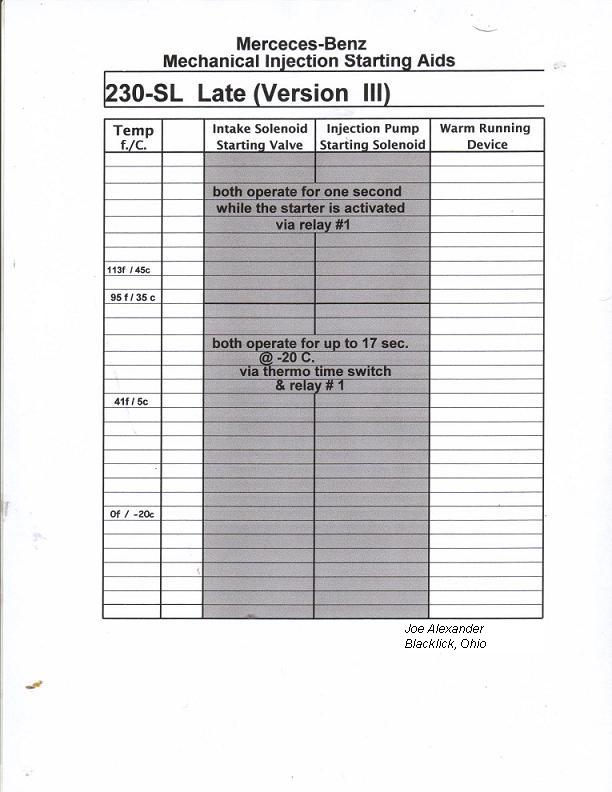

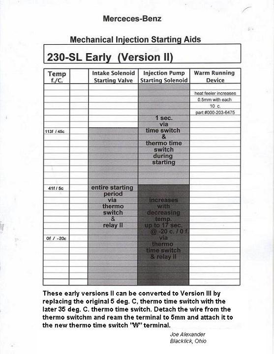

Hello Al,
The 230SL starting devices were especially confusing.  There are two types and they are designated version II and version III in the manuals to make matters more confusing.
On version II (early 230SLs) the intake solenoid is activated during the entire starting period. The injection pump solenoid is activated one second during starting above 41 deg. F. (5 deg. C). Below 41 deg. F. (5 deg. C.) the activation period increases as temperatures become colder, up to 17 seconds at 0 deg. F. (-20 deg. C.) via the thermo time switch and relay.
On version III (later 230SLs) at temperatures above 95 deg. F (35deg. C) both the intake solenoid and the injection pump starting solenoid operate for one second while the starter is activated via relay.
At temperatures below 95 deg. F (35 deg. C) both operate for at an increasing duration as temperature is lower (up to 17 sec. @ 0 deg. F. (-20 deg. C.), vial the thermo time switch and relay.
To improve hot starting characteristics the factory manuals state "early versions II can be converted to the later version III by replacing the original 5 deg. C. thermo time switch with the later 35 deg. C. thermo time switch. The original wire is detached from the original thermo switch and the ring terminal is reamed to 5mm and connected to the "W" terminal of the new thermo time switch.

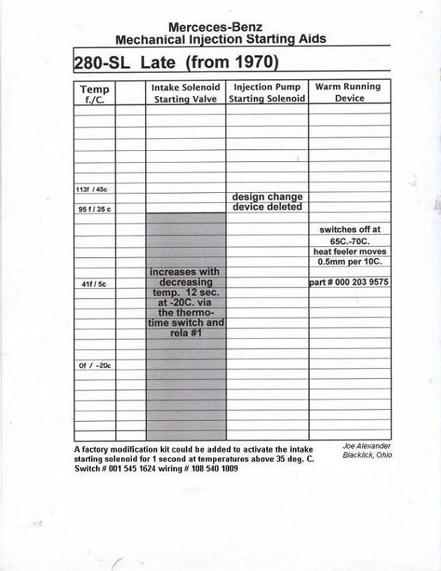

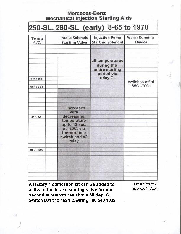

Here is my graphical interpretation of the starting aids. It's easier to understand.
Download Attachment: 230SLa.JPG
78.73 KB
Download Attachment: 230SLb.JPG
71.43 KB
Download Attachment: 250280c.JPG
82.96 KB
Download Attachment: 280SL.JPG
80.48 KB
I know what you mean Glenn, there are many other versions for various other models and years!
« Last Edit: March 04, 2007, 22:22:26 by ja17 »

Thanks, Walter, that makes it perfectly clear.  So the fact that my early model starts easier (when hot) with the momentary switch I installed is more an acknowledgment of the need for the improvement that Mercedes made in the later version than it is a testament to my engineering brilliance.  Oh well.

Strange situation in that you would need them both for a cold start but not for a hot start.
MB had several versions of the cold start system starting with the early 230sl.
It seems you are on the right track thinking of different volumes of delivery for the CSV.
One thing I noticed on a friends 280sl was that his CSV is physically smaller that the unit on my 250sl.
Of course the 280sl has a different inlet manifold also so maybe its CSV may need to deliver less fuel.

Here are some data extracted from the Service Manual (starting 1968) Series 108-113 Group 07-0/5.
Starting quantities cc/min at 0.5 atu test pressure:
EP/EV 2/2 70-80 (used on the 300sel 6.3)
EP/EV 2/4 118-132 (OD 61mm IP's with start solenoid)
EP/EV 2/5 138-152 (OD 36mm IP's without start solenoid)
I don't have the exact flow volume for the EP/EV 2/3 used on the early 230sl's, but it would slot in between EP/EV 2/2 and 2/4.
If a CSV (OD 61mm) with a higher flow volume is fitted to an engine with a starting solenoid on the back of the injection pump, it can result in an overrich condition when attempting a hot start.
Jaco van der Walt

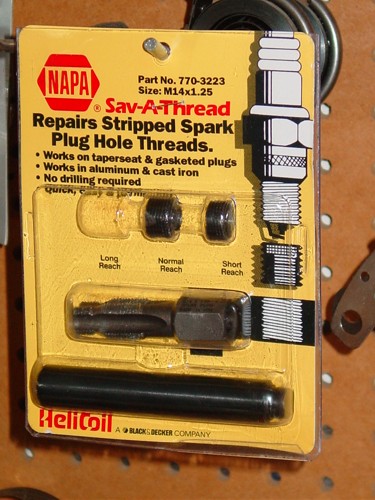

The pagoda is back on the road again.
On Saturday morning I was supposed to pick mein Frau at the ATL, but the flight from Sao Paulo, Brazil to ATL was diverted, seems the Columbians would not give Delta permission for the flight to enter thier air space, so it cricled around all night and before running out of gas had to land in Puerto Rico. So this gave me a couple of extra hours to stop by the auto parts and pick up a Heli-Coil set and install it.
The first step on the instructions said to "remove cylinder head", Not in my plans, so I used a couple of old shop tricks to keep the aluminum crumbs out of the cylinder.
First I took off the valve cover to make sure the valves were both in the closed position, and the piston was down toward the bottom of the bore, otherwise the tap could hit against the valve or bottom out against the top of the piston.
Next I filled up the flutes of the tap with axle bearing grease, this catches most of the shavings. after taping out the hole oversize, I cranked over the motor to blow any crumbs out the plug hole (put valve cover back on first so you don't pump oil all over the exaust headers like I did)
Then I took some BrakeKlean to wash any remaining bits out and the clean grease off the threads. crank over a couple times more to clear the brake clean out of the cylinder,
Use an old spark plug with the gasket ring removed to install the new insert, Put Permatex on outside threads first before installing,
Remove spark plug and see if insert is installed flush, then use the expanding punch from the kit and tap with hammer to flare out the threads and lock the insert into place.
Reinstall plug with ring gasker, wait one hour for Prematex to set up.

Al,
When you do the last step with the punch, doesn't the tab from the helicoil break off and fall into the cylinder? Or do you have an old shop trick for that too?
Did you decide to go to Blacklick? I'd love to meet you in person as after reading your chronicles you are now legendary in my mind.

Paul
The insert kit that I got at the NAPA store has the Heli-Coil brand but is not the coiled wire type insert. the "trick" on those was to snap off the tab using a pair of needle nose pliars.
This kit was more like what I rember as a K.D. insert it is machined out of tubing with threads inside and out. With the added feature of the top three threads on the outside are knurled to bite into the aluminum when installed. Then the punch in the bottom of the package has a taper that expands the top of the insert to get a better bite. The old helix wire and K.D. inserts were notorious for backing out of the head when it came time to change the plugs, even with Locktite on the outside threads and Anti-sieze on the plug threads. When it is's time to change out these plugs I'll find out if this system works better than those old ones.
