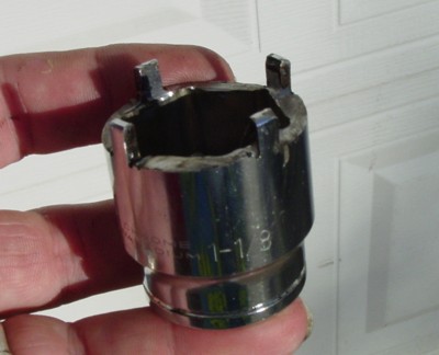

Because banging on a spanner nut with a chisel never works very well I decided to make myself a spanner socket. The nut was loose enough that it came out by hand. I took it along with me to the hardware store and found a 1/2" drive socket with the same OD as the spanner nut (an 1-1/8" socket) Then using my RotoZip tool's flex shaft and a Dremmel metal cutting disc I cut out four teeth that fit into the spanner nut. When the socket got too hot to hold by hand I would cool it in a bucket of water so it wouldn't loose its temper. I put it on my 1/2" impact and it worked perfectly.
Download Attachment: spanner.jpg
27.87 KB

hey Ya'll
Keeping a unicycle in the trunk for an emergency ride home seems to be working. I drove about 25 miles out on the road this afternoon, the car drives flawlessly. Just the way I remember. Possibly even a little better. I've been keeping it under 3000 revs and 60mph for the break in. But it is still a thrill to drive.
Tightening up the flange nut also made the 2-3 shift a lot smoother.

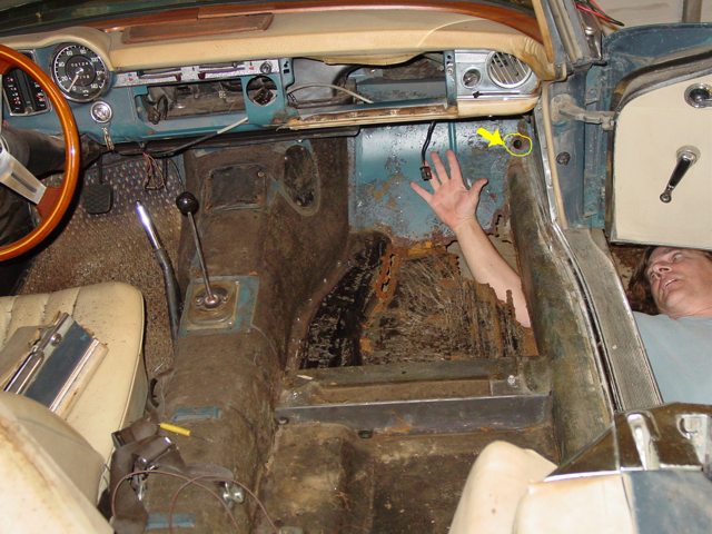

Hey Ya'll
In order to make my car driveable enough to get around safely I need to get some floor boards down below my feet.
Download Attachment: right floor board.jpg
81.67 KB
Replacing rusted sheet metal takes some planning before tearing in and hacking away everything that looks rusty.
In the case of my car, there would be nothing left. So a plan needs to be made as to what extent the repairs will need to go.
My car will never be a show car, so replacing everything that even shows a trace of rust is out of the question, on the other hand I have higher expectations than just pop riveting in pieces of roofer's flashing and stuffing the holes full of old news paper and smearing them over with Bondo filler. You wouldn't believe the things that I have found under a layer of bondo on these cars. Fortunately I am the only one to have ever done any body repair on this car, so I don't think I'll find anything hiding inside the quarter pannels.
I have some new reproduction sheet metal on order, the lower panels (where the mouldings mount) for the front fenders, and 3/4 reproduction fenders for the rears, a left outer rocker pannel (the one that screws on) and a pair of rear frame sections (The dog leg in front of the rear axle) The rest I plan on making out of flat sheet stock.
The right floor board in the photo is in much worse shape than the left because of the hole that was drilled for the Kuhlmeister's evaporator drain (yellow arrow) was directly behind the tire and allowed the water that splashed up to fill up the floor pan. I rember once finding an inch of water there when I pulled up the carpeting.
I worked this week on welding new pannels in on the driver's side floor. Because the frame box section of the rocker pannel has rust damage too, I chose to start by welding in a piece of 11ga. sheet steel bent into an 1" angle. I welded this to the outer frame box section giving this section some added structural strength to mount the floor to.
There was a small hole about the size of a pea under the accelerator pedal by the time I got the pedal mounting bracket cut away, there was a hole almost 8" square to repair. I had to remove the mounting brackets for the fuel and brake lines to get them out of the way before I could do any welding there.
I kept a large fire extinguisher handy, but I came up with a handy way to put out the rubber undercoat that would burn as I was welding, I kept a pump-up style lawn sprayer filled with water by the car while I was welding, when a little fire would pop up I would give it a spritz of water and go back to welding. In the past I had used buckets of water and wet rags this would leave puddles of water everywhere, not a good idea when electric welding.
Hopefully by about this time next week I'll have some reproduction sheet metal here and can start tearing into the fenders.
I think instead I may want get the holes in the floor welded up and then start driving the car around so I get enough miles racked up to change the break in oil. Then I'll start ripping away at the exterior sheet metal.
Al  :O)

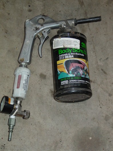

hey Cees
That's the $64,000 question. How to make metal repairs that are rust proof (resistant). I once had a sales brochure from Mercedes about the upcoming release of the new /8 models, It showed in detail all the procedures the new 68 models went through to make them "The first truly rust proof automobile". Well that didn't pan out very well, after a couple years of winter driving we all know what happened.
My basic plan is to seal both sides of all the metal surfaces, at the factory they were submurged in a bath of electrostaticly charged water based sealer, the light grey layer, then the bottom surfaces were coated with a rubbery substance that I think was heated and sprayed on in a molten state, then the whole thing was primered and painted.
I have a undercoating spray gun
Download Attachment: Body Schutz.jpg
63.38 KB
This sprays on a viscos tar like substance that takes about 48 hours to set up, then it can be painted over. Yesterday when I was at the auto parts store I saw that they had gallon containers of spray on pickup bed liner, This when set up has a harder surface than the tar based under coat. I dont know if there is a product that sprays on with the extremely high amount of texture that the original rubber coating had.
When finished every metal surface should be coated if possible painted. Unpainted primer isn't a very good metal sealer, primer has a high solid content (calcium carbonate, gypsum, chalk and the like)  it is designed to fill up surface irregularities, but this also makes it poruos so if left unpainted moisture will eventualy soak in to the metal.
My goal is to get about 10 more years of life out of this car, If if holds up longer, that will just be a bonus.
Maybe by then someone will be making a reproduction "body in white" that I can transfer all the running train onto. We all can hope any way.
Al  :O)

Hello Cees and AL,
Metal repairs are great, however the heat from the welding burn the coatings off the rear side of the panels. In addition a lot of acids and other corrosives are introduced from the welding process. The metal must be thoroughly cleaned and treated before priming and refinishing. The repair must be sealed off completely to prevent moisture from ruining the job in the future. Clean and coat the backside if possible. You can flush clean repairs a commercial solutions before priming. I used to use a bare metal conditioner made by 3m. It etched the metal and neutralized any acids before priming. It also removed any surface rust from bare steel.  Like AL said, primers are porous and should be covered with finish paint before prolonged exposure to moisture.
If you are doing chassis repairs use a good rust primer then a finish paint and then the undercoating. I have used the 3M body schutz that Al mentioned. It is a good product and you can get close to the original texture with the special gun which is not that expensive.  The product is also available as 3M rubberized undercoat in aerosols but is a much finer texture.
I have used the Sekkens ( of The Netherlands)  body schutz which is an original Mercedes OEM product at times, from what I have heard. With it's gun the texture is perfect as original if done correctly. Surprisingly it is a water base product! After it dries it is very durable. It accepts paint well and repairs are invisible on the undercarriage if done correctly.
As Michael has said, keep them clean.  I like to drive the car after washing to help blow dry moisture out of the crevices. Repairs must be made watertight and sealed and treated to last. The Eastwood Co. has lots of restoration products and information available online.
Mercedes or it's suppliers will also supply all original paints, primers and undercoats if you can take the the sticker shock.
Newer professional products like two stage epoxy primers are superior but harder to use, more toxic than the old lacquer based primers.
Nicely formed all metal repairs, hammer welded into place are nearly a thing of the past. Cost and lost know how, making these techniques extinct except for in the better restoration shops. New synthetic fillers are economical, easy to use and can last when used correctly.  The same rules apply, make good repairs, treat the metal, seal the repairs well and keep it clean.
