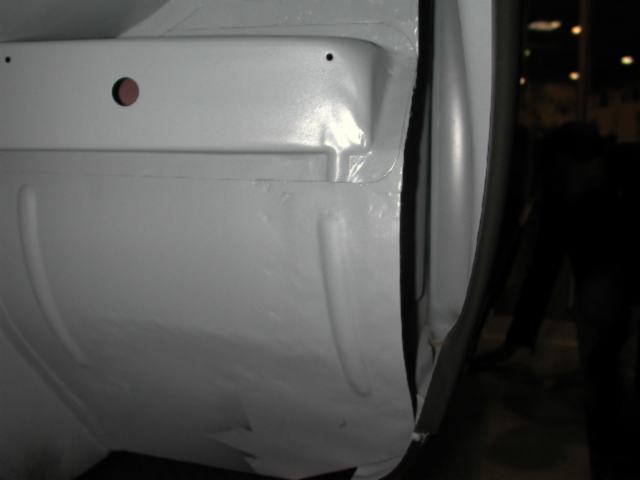

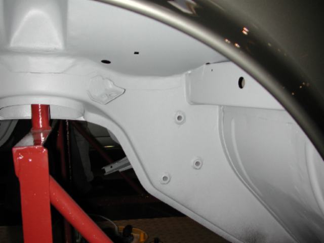

« Reply #3 on: June 12, 2006, 15:31:54 »
These any help?

merrill
  • Posts: 1386
Re: under body question
« Reply #4 on: June 12, 2006, 17:24:39 »
Naj,
yes!  looking at the last photo, you can see where the fender curvs back down on the inside, and mates up to a boxy item.
on my car the tape continued the curve from the fender down to the wheel well.  thus the area was "smooth"
guess the tape was not supposed to be there?
thanks
matt

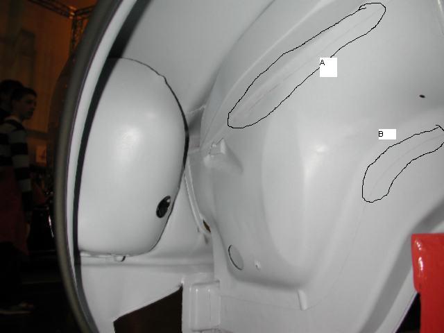

  • Posts: 4899
« Reply #5 on: June 12, 2006, 21:20:49 »
Was the tape right under the box section ("A") or down lower ("B")?
Download Attachment: TapeHere.jpg

merrill
  • Posts: 1386
« Reply #6 on: June 13, 2006, 07:11:53 »
Rodd,
The tape is about 5' wide,  so it covered A and went up and mated with the fender where it mates with the box section at A
Is this normal?
matt

Vince Canepa
« Reply #7 on: June 13, 2006, 08:19:31 »
The tape is not original.  My guess is that someone put it there to stop moisture holding debris from collecting atop the longitudinal box section (a).  I have seen rust start there.
Vince Canepa
113.043-10-001543
568H Signal Red
116 Caviar MB-Tex
  • Posts: 4899
« Reply #8 on: June 14, 2006, 10:53:21 »
You would not believe how much dirt & grime were packed into that small space above the box section on my car when I bought it.  I highly recommend that everyone check this area on their car if they have not done so in the past.

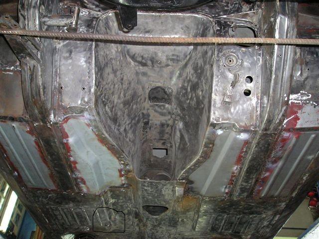

Originally posted by naj
Hi, Bob,
Don't think there should be a hole in the middle.
Didn't see one on the 230 when I had the mats out recently.
Is it in this pic.? (Finn's 230)
 http://www.sl113.org/forums/uploaded/mille/200572517711_P4201020.JPG
hey Naj,
The exhaust rubber ring brackets are missing from that pic but I have circled the area I think is relevant.
The hole is on the sloping part of the underbody.
thanks
Download Attachment: underfloor2.JPG
