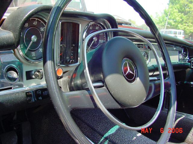

Yes, the US-spec cars were fitted with a Hazard Switch on the dash at some point. I believe they all got a hazard switch at some point. Take a look at the attached photo. Note the red knob to the left of the steering wheel:
Download Attachment: 18_4.JPG.jpg

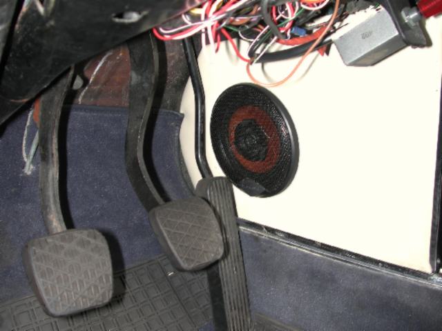

To add Hazard Warning to a 250 SL you would need the complete assembly which includes a heavier duty flasher unit and switch with knob, and it would have to be wired in. When you pull the knob to switch them on, the power to the normal flasher unit is cut-off.
Here's a picture of a Hella unit I added to my 280 SL. It is mounted under-dash (top RH corner)

p.s: Ignore Jack's wiring  :oops:

Hey Naj, I was about to ask why you put a speaker in the Trans. tunnel...  :|
'HOT' air makes better sound [:p]
