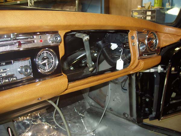

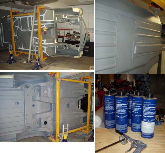

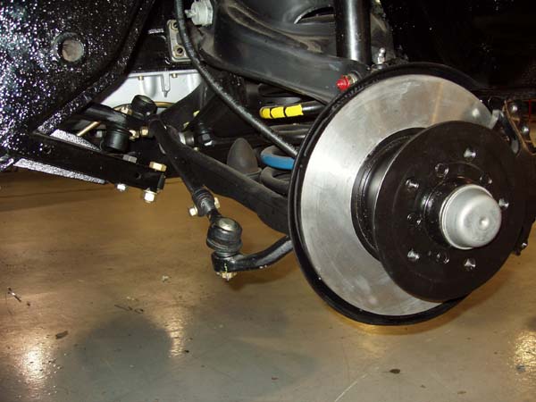

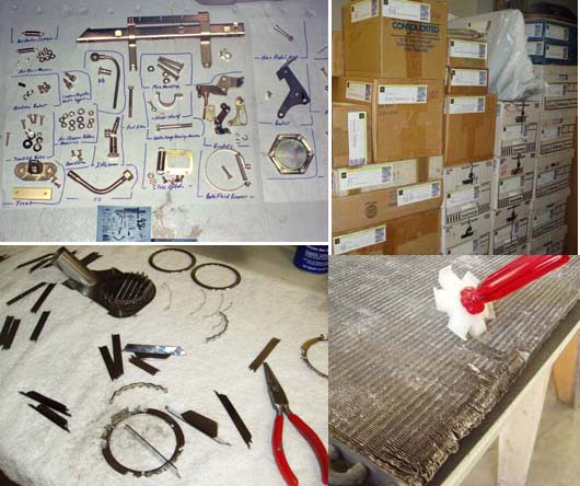

A number of you expressed interest or had questions about my resto and did not want to hijack the "winter projects" topic. Sorry if i'm not able to post as often as I would like.
#012277 European delivered (Duisbreg Germany) then imported to US
NOTE:  Still need original small trunk mat and Bosch horn tags (set) help anyone !
This restoration has taken approx. twelve years, it was on hold for a  lot of those. Yes, costs are into the six figures, and I did most of the work! Originally the car was brought to Scott Restorations in L.A. just in time for them to go out of business.  I pulled the car and had someone strip and rebody, however I was unhappy with their work so I pulled the car again and did most of the work myself.  There was a good deal of rust removed (this was a lucky car, should have been parted out) everything on the car was removed and stripped to bare metal, and corrected. The entire underside was stripped, primed, seam sealed, and undercoated using MBZ material.  All chrome went to Christensen Plating in L.A. (the best, but took 4 months). The engine long block rebuild by Metric Motors in Canoga Park, CA. included balancing crank/flywheel for the manual to auto trans conversion (wife can't drive a manual -- she crashed this car during the test drive) they (and gernold at SL Tech) also helped me sort all the pulley's etc for the AC. I did all the component refinishing (bead blasting, cleaning, and painting of various parts) sent to Van Nuys Plating for cad. The body panels tweeked and paint prep was done by Rocky at Johnson Classics in Riverside CA (subbed by Strauss).  Paint and the final assembly is currently being handled by Bell Strauss Auto Care (formerly Bruce Strauss Auto Care) in Costa Messa, CA.  They laid down the beautiful two stage paint for exterior and single stage used on engine compartment and under car.
Not perfect, just done the way I wanted it.

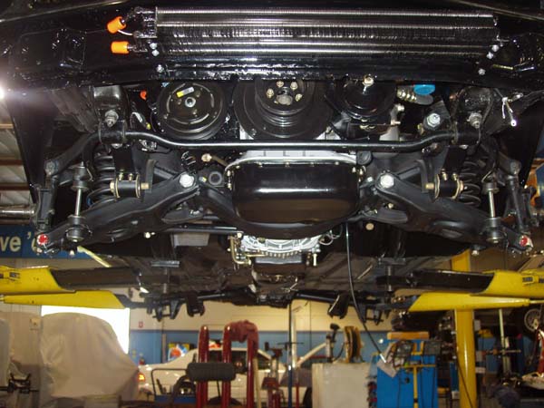

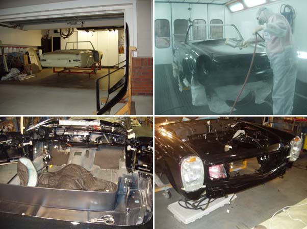

« Reply #12 on: November 21, 2005, 10:49:16 »
progress update...

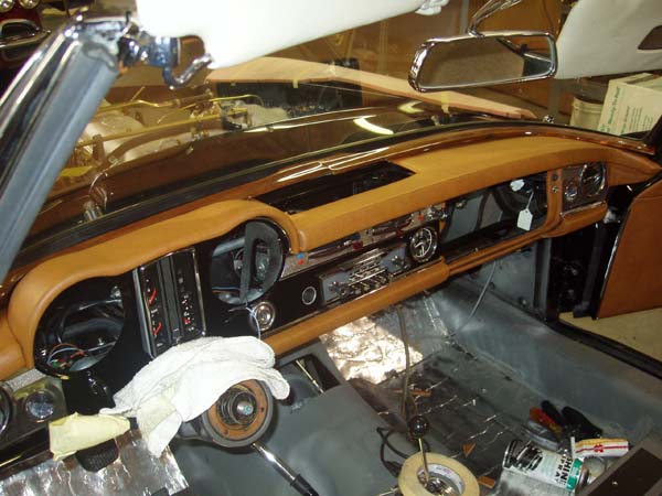

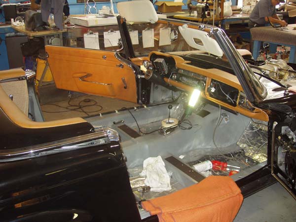

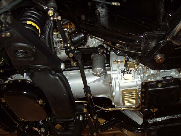

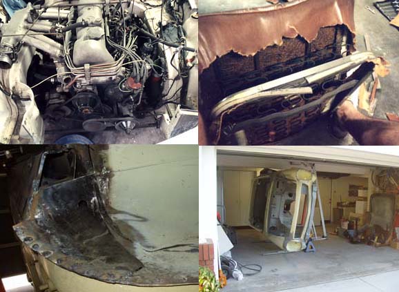

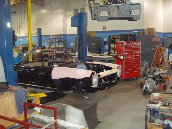

Download Attachment: PA110071.jpg
47.5 KB
Download Attachment: PA110076.jpg
50.32 KB
Download Attachment: PA190110.jpg
45.09 KB
Download Attachment: P1010032.jpg
56.15 KB
Download Attachment: P1010038.jpg
41.89 KB
Download Attachment: PA190116.jpg
53.74 KB
Download Attachment: P1010085.jpg
40.16 KB
Download Attachment: PB180005.jpg
50.76 KB
Download Attachment: PB180014.jpg
35.05 KB
Download Attachment: PB180023.jpg
48.35 KB
Download Attachment: PB180081.jpg
51.04 KB
Download Attachment: PB180093.jpg
57.45 KB
