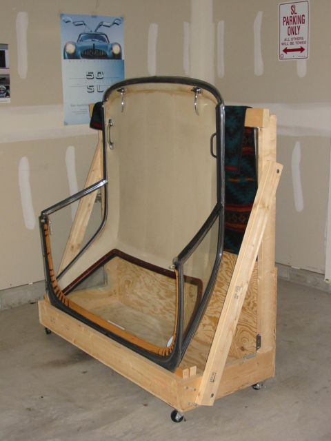

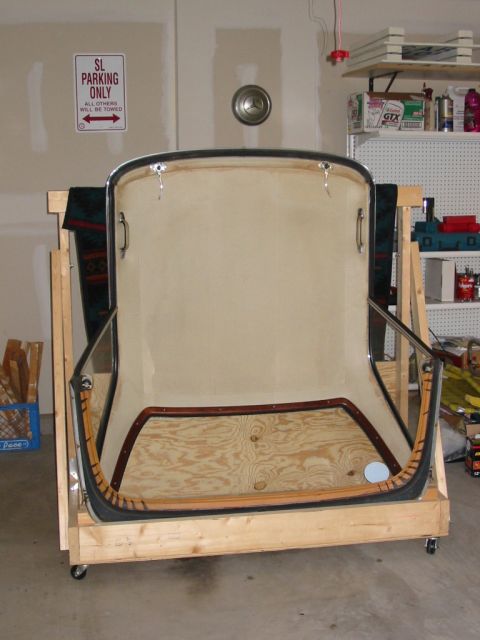

I made mine from lumber.  Want any dimensions or costs?

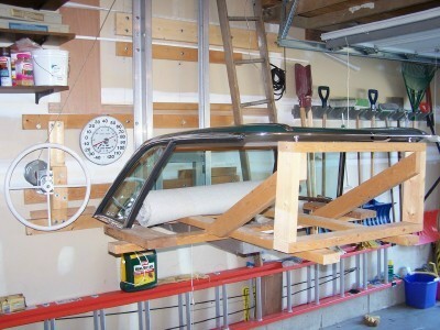

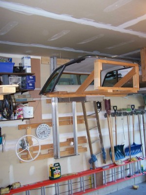

Here are pictures of how I store my top for the summer.  I do not have enough garage floor space.
Download Attachment: top store B.jpeg
52.17 KB
Download Attachment: top storage A.jpeg
64.77 KB
I mounted a ununsed personal water craft lift on the side of the garage; used a lot of lag bolts.  I did build a frame to accommidate the top on the lift.  One day I might build a manual lift to get the top from the car to the storage rack.

Rodd,
What are the weight bearing areas on your " top dolly"?  That is similar to what I was looking to build, I'm just questioning how to distribute the weight of the HT.  Can you provide more pics and maybe some close ups?

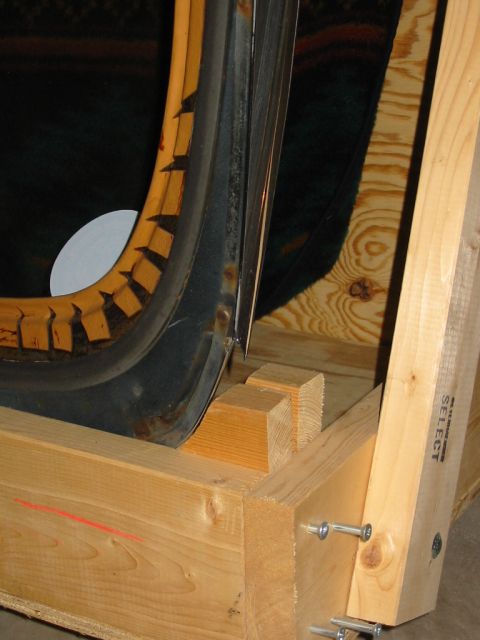

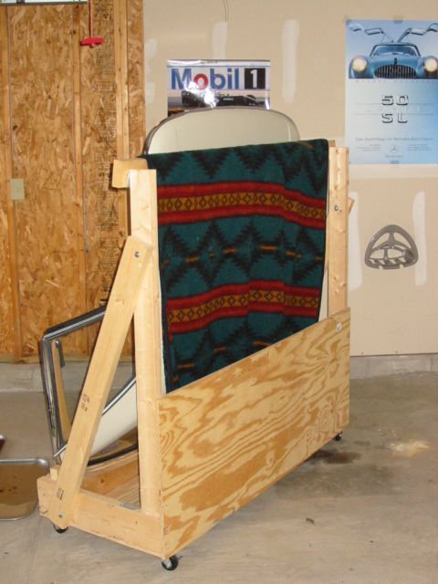

Andre,
I traced the curve of the back of the hard top (below the rear glass) and cut a pair of 2" x 8" boards to match as best I could.  This was an attempt to distribute the weight across the width of the rear chrome trim.
The base of the "cart" is a 3/4" plywood at 24" x 60".
Download Attachment: Copy of IMG_2779.JPG
44.11 KB
The wood around the edge of the base and the verticle pieces are 2" x 6".  I have a metal angle bracket at the back.  The verticle pieces are 48" long and rest on the lower 2x6.  There is another 24" x 60" piece of plywood on the back for stability.
Download Attachment: Copy of IMG_2782.JPG
56.21 KB

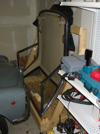

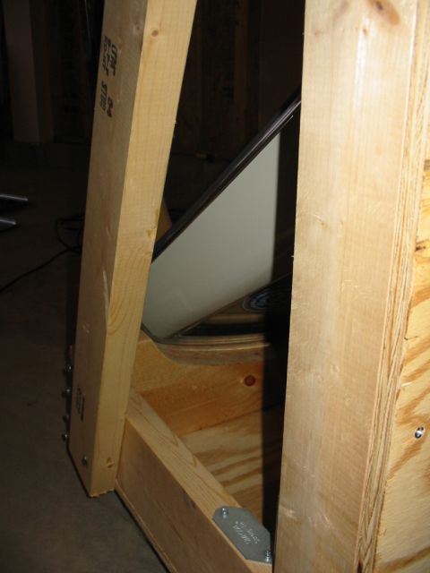

I should buy a proper cover for the top while it's stored on it's cart for 8 months of the year.  I just drape the blanket over it.  Here's a couple more shots.
Download Attachment: Copy of IMG_2781.JPG
49.67 KB
Download Attachment: Copy of IMG_2785.JPG
38.67 KB
Download Attachment: Copy of IMG_2786.JPG
49.52 KB
