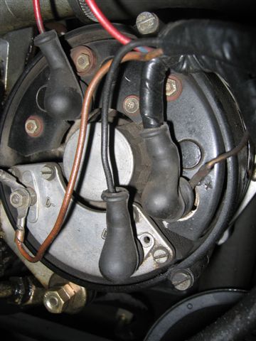

I took this shot of the back of my alternator.  Can anyone familiar with the noise suppression equipment tell me if it exists here?
The BBB 230SL, has job 82-20 for radio suppression.
It lists the suppressors needed throughout the electrical system.
Download Attachment: Alternator.jpg

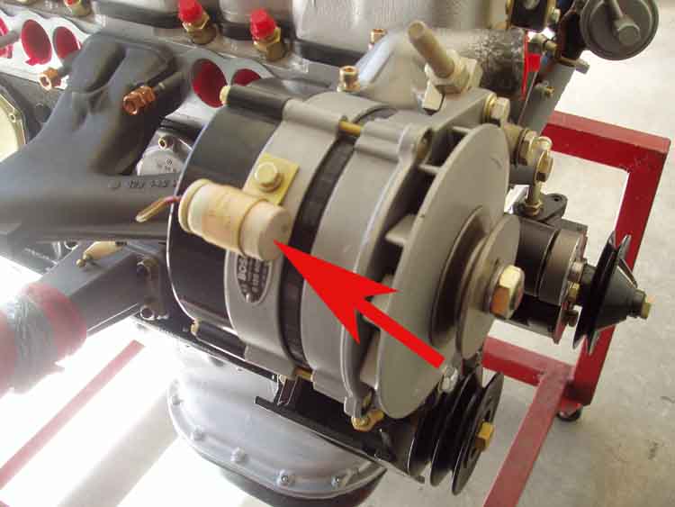

I was told that the item highlighted was for radio noise surpression.  Hope this helps.
Download Attachment: P1160037.JPG

Mike,
The thin Brown wire that is seen on the RHS + terminal looks to be going to the suppressor/condensor. (They are the same type of thing as on the distributor but they are treated separately)
It will only have one wire and will earth through its case to the body of the alternator.
