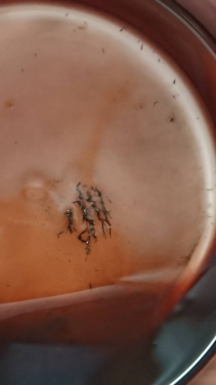

Thanks everyone... Chaging the oil has made a significant improvement! All gears now feel the same to get into.
I replaced all the nylon washers when I got the car as they were toast.
No needle jumping on acceleration/taking foot off accelerator.
There was a little ferrous material in the drained fluid... Is this normal? All of it is in the picture.
