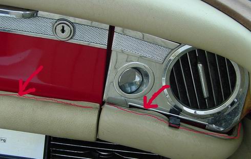

- Dash metal panel where the clock located is pent a little bit inward so its misaligned with the glove box lid, someone forced it in trying to get into the glove box with a small crow bar or screw driver( how difficult this to fix?)
- Right chrome vent is loose, and two chrome strips are missing
Download Attachment: missing dash chrome1.jpg
29.11 KB

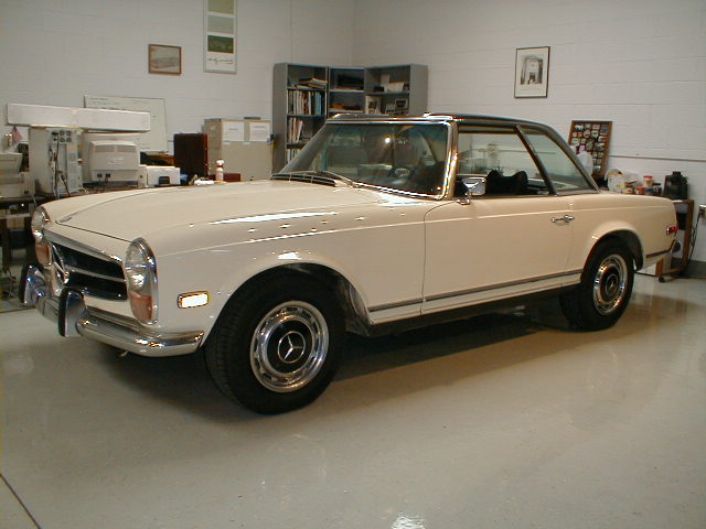

I purchased a 1971 280sl in June 2004. 136k original miles on a car with consistently low mileage years (i.e. best I can tell, never sat undriven for extended period). Photo below taken day of purchase. It had only a trace of rust on the trunk floor. Original paint, headlight notches and all spot welds intact. All numbers match. Showed no indication of ever being wrecked. Car was very complete; had all manuals, original window sticker etc, etc., most records, tools. Original working Becker / Hirschmann, solid engine and tranny, average tex interior, wood, carpet all fair to good but showing wear.
Accelerator linkage was sticking but easily fixable. Asking price was $25k, paid 12% less ($22k). Spent about 8 months aggressively searching for a great restoration candidate (very complete and original) and considered this an excellent solution and very good deal. I'm a firm believer that more often than not, it takes time to discover a great purchase opportunity; as in several months (or more), not several weeks. Be patient, don't rush and never hesitate to turn one down and keep looking.
I hope this information proves useful in the  assessment of the car you are looking at.

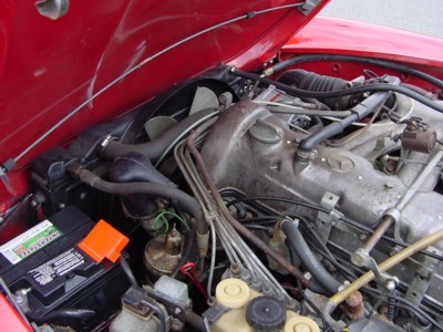

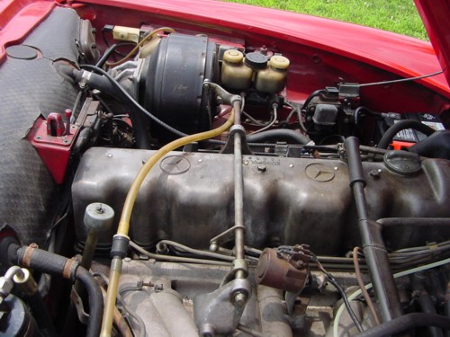

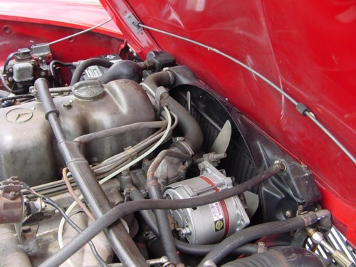

Do you have a photo of the engine bay you can share? That usually speaks volumes about a car.
Also, is it originally a red car? Seems like most of the red SLs out there started out a different color.

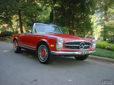

I would also like to point out that the side reflector in that rear photo looks too high. I am always uncomfortable seeing things like that and would suggest you take a magnet to the body and examine it for filler.

Here are some more pictures
Download Attachment: Pagosa2.jpg
62.44 KB
Download Attachment: Pagoda 3.jpg
45.23 KB
Download Attachment: engine4.jpg
62.8 KB
