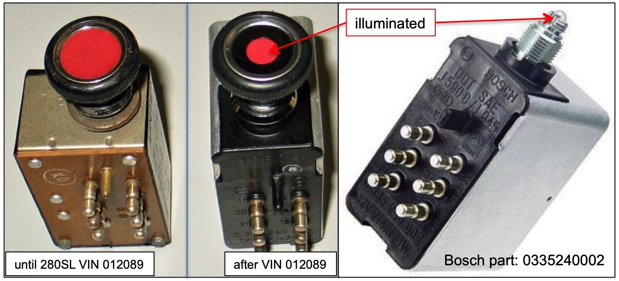

Reading through this and similar posts and the tech. manual it is clear that an electronic turnsignal/flasher relay is required when installing LED turn signal bulbs (https://www.sl113.org/wiki/Electrical/FlasherRelay).
But what if a car, e.g. late 280SL, has already the Bosch illuminated electronic relay that combines the thermomagnetic turn signal controller and the mechanical emergency/hazard relay? https://www.sl113.org/wiki/Electrical/HazardWarningLights
Is this electronic hazard/emergency relay compatible with LED bulbs? Or does one need to add resistors?

  • Posts: 4774
Re: LED indicators / flashers
« Reply #12 on: November 17, 2020, 18:32:00 »
Correct, IF you have the thermomechanical flasher unit.
But when you have the later Bosch unit installed you do NOT have it any longer, it is not functional. Thus my question, will LED bulbs work with the Bosch flasher relay?

What part number Bosch relay do you have?
1970 280sl 4-Speed Horizon Blue
  • Posts: 4774
« Reply #14 on: November 18, 2020, 01:08:44 »
The one shown in my link to our technical manual Bosch #0335 240 002:
Since I received no answers I did some crude testing and found out that with two pairs of LEDs hooked up to the switch the turn signal function will not work although it did with normal incandescent bulbs. Pulling the knob to test the emergency flasher function the LEDs started flashing as did the bulb inside the knob. However, the frequency was faster.
Why one works with LEDs and the other does not I cannot explain, perhaps others can.
Chris Long
  • USA, NJ, Morristown
  • Posts: 179
« Reply #16 on: November 21, 2020, 01:54:48 »
Not enough resistance in the circuit - an led flasher is v easy to install under dash and reservable.
