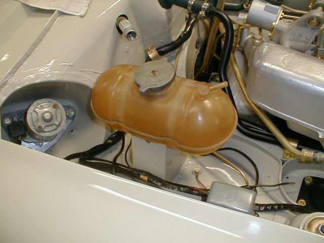

The biggest problem with a nicely detailed engine bay is the unrestorable discolored plastic component or two that now stick out like a sore thumb.
The capsule shaped, coolant expansion tank presents that problem for me and that is where I'm looking to you all for help. My car, being a 1971, has the plastic tank which I assume was once white, rather than the rust brown color it is today. I've found a replacement from MB, a mere $556, [:0] but am not in the mood take it up the tailpipe as I obviously would if I paid that much for a simple plastic part that makes a replacement sunvisor look cheap. I've looked around at some of the parts suppliers websites but see no indication that these are available from them.
So here are my questions. Does anyone know:
 :?:   If it is possible to restore one of these to like new condition? (doubtful)
 :?:   If it is possible to purchase a new one for a reasonable price?
 :?:   If the earlier black ones are available?
 :?:   If the black (steel I assume?) ones are considered 'accepted'    substitutes on a '71 model and is that a good, logical solution?
OR
[:0]  Is this the color it is supposed to be?
All other thoughts and ideas are greatly appreciated. Thanks very much.

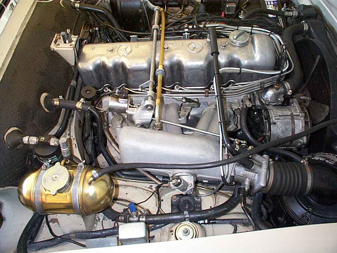

My car is registered as a 1971, production of June 1970, in service date of October 1970.  It has the brass tank.  When I bought the car in June, the black paint was still partly on the tank.  I cleaned off the black that remained, and it is now displayed in all brass.
Download Attachment: overflow.jpg
