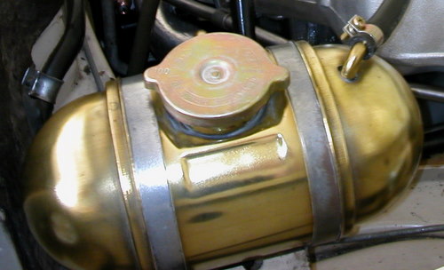

I was very impressed brass expansion tank in the picture posted by pbossel. After removing the black paint, how do you go about making it look like that?

Hello Andy,
When I bought my 113 a few years ago, the tank was peeling and looked ugly.  To make my brass tank shine, I removed it and used a brass wire wheel on my bench grinder.  I then used some metal polish and manually polished it with some rags.  When I could see my reflection, I stopped....  scared myself[:0]!
Now I am in the process of having the black paint put back on the tank to bring it back to its original finish...

Every time I see an unpainted brass tank, it makes me cringe.  I have never said anything because it makes the owner happy and it's their car.  But to me, it sticks out like a sore thumb and detracts from the look under the hood.  When I rebuilt my engine, I stripped and polished the tank and it struck me like bling on a mini-van.  So I painted it.
To each his own, but the shiny brass doesn't appear anywhere else on the car and it won't stay shiny for too many years.
If the plastic really offends your visual sensibilities, there are special plastic paints that could render it black.  I painted the plastic instrument panel in an airplane and it still looked new 10 years later.
