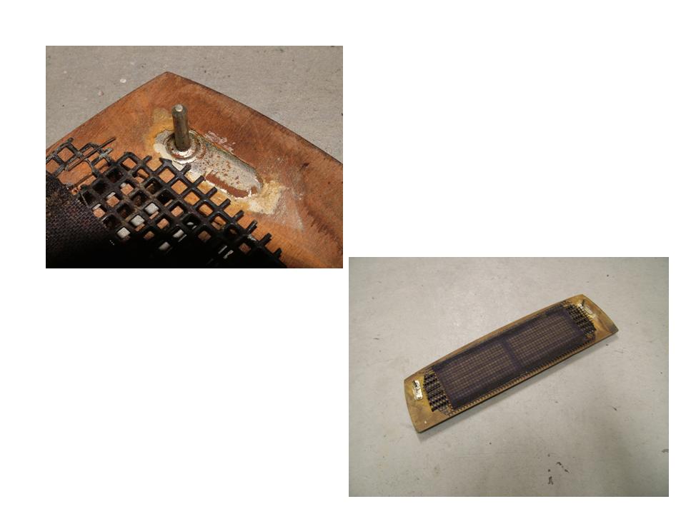

Well, no for the 230. Instead two pins that goes to clips in the dash. See https://www.sl113.org/forums/uploaded/sjiatrou/2007210203042_SpeakerGrill.jpg
and https://www.sl113.org/forums/index.php?topic=6514.msg40646#msg40646

The cutoff between pins and screws in the speaker grill was made in beginning of November 1965 from VIN #14090, according to Pagoda Notes Vol. 10 No. 2.
