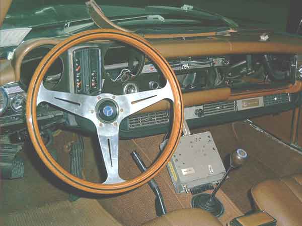

« Reply #9 on: July 24, 2003, 07:16:19 »
When I started this topic in April, I was a know-nothing...now I'm a smarter know-nothing because since then I've been there and done that...
I was surpised to read in Longtooth's post here that he had to drop the AC to access the instruments. His is a 250SL and mine a 280 SL but I don't think that should make any difference.
I was able to access the instruments without touching the AC. Maybe it was beginner's luck but I put my head on the brake pedal then reached up behind the dash to loosen the tach bracket. Once the tach was out, I could reach into the tach hole to get at the center cluster and the speedo. I didn't remove the center cluster, just loosened it and pushed it forward since my problem was with the speedo.
But unless I missed something here, maybe the AC does not have to be touched to access the instruments.
The photo shows the instruments out with the AC still in place. (The radio and glove box are also out but that was to get at the heater levers not the instruments.)
Download Attachment: dashapart.jpg
