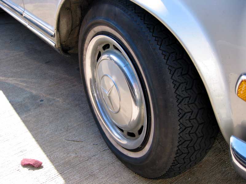

Hi all. I just made the leap into Pagoda ownership about two weeks ago. I didn't pay too much attention to the tires on the car other than knowing that they'd need replacing. When I went to pick up the car from the owner he mentioned that one of the tires was so bad that he put on the spare so I could drive it away. After closer inspection, and reading many of the posts here, I've come to the conclusion that I've been driving on the original Firestone Phoenix spare for the last few days (minimal miles). This has been confirmed by a very knowledgeable Pagoda owner as well. Upon realizing this I've ordered a new set of tires (the Coker Phoenix) and the car will now sit until they arrive. Attached are two shots of the tire.
Download Attachment: Phoenix1.jpg
39.03 KB
Download Attachment: Phoenix2.jpg
49.23 KB

Just a heads up.  I think that the tread width and/or rolling diameter of the Coker "Phoenix" tires is just a little oversize.  I say this because it appears that it is a slightly tighter fit on the spare tire mount of my '66 230SL.  The tire comes into contact with both the fuel filler neck at the rear and the wheel wheel well at the front of the spare and top (inner) sidewall interferes with the trunk hinge on that side.  How I noticed this is that the trunk hinge has made a nice impression on my spare tire cover and that corner of the trunk is not sitting flush with the fender line anymore because of the interference with the new spare tire.  I think that the only way to take care of this problem is to let the air out of my spare - which sort of defeats the purpose, don't you think?

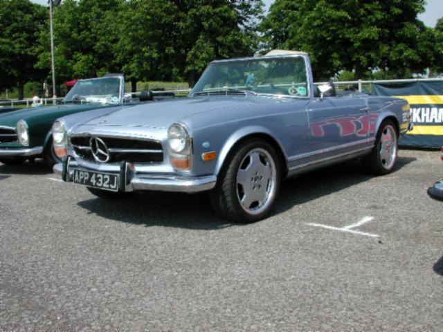

This sounds like a fairly sensible idea, but for one thing: the speed rating on these Van-Life tyres is only 'T' - up to 118mph(190kmh).  Whilst I doubt you'd ever consider doing these sorts of speeds in your Pagoda, it is considered bad practice to use tyres that have a speed rating lower than that of the maximum speed of the car - which is why modern sports cars often use 'Z' rated tyres or more.
I'd personally like to think that if I popped over to Germany and went on the Autobahn to see what my Pagoda could do in terms of top speed, my tyres could handle it....
Rhodri
Maybe some 215/45 'Z' 17s  :?:

Oddly enough Naj, I have seen those wheels look a lot worse than that. Must be that the Pagoda can carry them off!

A 113 with alloy wheels and low profile tires always reminds me of a time back when I was still in highschool. I had just mounted a set of Mikey Thompsons on Cragar uni-lugs for a friend's 68 Mustang. Because they were uni-lug wheels I bolted them on my 65 230sl. The fronts were F70-14's on 7" wide rims, the rears were something like J60-14's on 12" reverse offset rims. They looked realy stupid, and that was the point. But to put icing on the cake I duc-taped on a Firebird rear deck spoiler.
My father when he came into the shop was somewhat less than amused. His responce was his usual parental admonition, "Alan don't be a f---ing idiot."
I still have issues.
