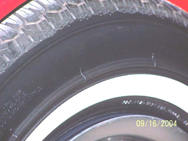

i had a set of coker tyres put on my car before importing it,they have now been on just over a year,and my only complaint is that the white band on two of the tyres has gone a brownish colour as if the black of the tyre is bleeding through.it isnt down to road use as i have only covered 200 dry miles in the last year,i have read posts on stuff to put on to make them white again,but the point is should it have happend?,and as the car is now in spain theres not alot i can do.and as you know they are not cheap.
i will try to attatch a photo as my car is also signal red ,and you can get an idea how they will look{when new}.
anybody else had this problem?
andy.

I can also say that I am still pleased with the Coker "Phoenix" tires.  I've put a little over 500 miles on them and the car tracks and handles well.  The only complaint I would register is that they "flat spot" fairly noticeably when parked for any time.  It takes about 10 miles for them to work the "flat spots" out and then they are fine.  I have not noticed the "browning" of the white walls but now will check them carefully for this.

I've read that products such as Armor-All will cause brownig/discoloration of the WW.

that product amor-all sounds like something that is put on to protect the tyre,or is it in the rubber?.whats strange is its only happend on two of the tyres.the spare is i think the original phoneix,and the band is perfectly white after 34 years.

One of my Coker's seems to have a little browning of the white wall.  Without much thought I assumed it to be the result of one or more of the tire shine products I may have sprayed on.  If you use those products, they tend to leach brown gunk off the tire and that is what is staining the WW.
Coker sells (of course) a WW cleaner which I should have bought but I didn't.  I had a heck of a time getting this blue varnish off the WW that they put on to protect the WW during shippin.  Even the detailer at the place that balanced the wheels for me couldn't get it off.  In spring I'll buy some of it.
