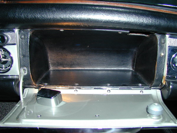

Not sure what you mean, but here's a photo:
Download Attachment: gbox.JPG
79.29 KB

Does the hinge mount right under the bottom flat piece that is secured by screws or is it mounted under the metal glove box?
Re: Glove box door hinge
« Reply #3 on: September 03, 2004, 17:44:01 »
Under the metal glove box.

Hinge goes ABOVE glove box base. On RHD cars, the right end of the hinge has a raised section that the flex wire for the lamp in the door passes under!!
The hinge/box are held on the dash by 4 screws but there are 6 holes. The two smaller holes take rivets which hold the glove box and door together so that the spring/holders can be installed prior to fitting the assembly into the dash board.

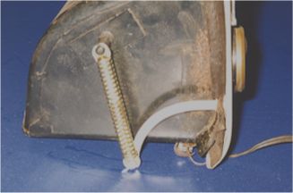

Take the two "wrench" handles and put each of them into the holes/circles formed at either end of the spring so that the handles are inside the spring pointed towards one another like so.... ]-/////-[
Now squeeze them together by pushing on the wrench heads, compressing the spring until the handles overlap inside the body of the spring.  Now with the glovebox closed, insert the wrench ends ] into the slots in the hinge arms. The wrench handles should stay overlapped and the spring should stay compressed with the glovebox closed. Done correctly, there should be enough tension on the gloveboxe hinge to make it difficult to open when the glovebox is not attached to the car. If you are bending the spring or the wrench handles do not overlap you are doing something wrong.

Here a couple of pics to look at
Download Attachment: GloveBoxForkSpringKit.JPG
32.88 KB
Download Attachment: GloveboxSpringInstalled.jpg
12.59 KB

My glove box is held in place by two screws on the top and four on the bottom. They are chromed and sit in thin (what looks like) aluminum cups through the MB-tex material.
