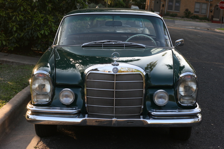

I also have a '68 111024 (see attached picture). It is in good original shape (California) and have been doing a rolling restoration on it for the last two years. I am currently working on the front and rear wheel wells removing some minor rust and then restoring it. I can take some pictures if you like.
Something odd I found was the color of the splash shields. Mine appear to semi-gloss black on the back but BLACK undercoat on the front with no body color paint. The rest of the well is beige undercoat with body color sprayed on top. Can anybody confirm this?
Since there are so many 111 guys here, I have a question. Do you have to remove the lower windshield chrome strip in order to remove the air scoop?
Peter, let me know what pictures you need and I will send them to you.
Yes, both lower trim strips need to be removed. Insane, I know.
The trim strip is held in place with a series of plastic body plugs, so a soft plastic spatula or trim remover tool would be best. The ends of the trims pieces are held in place with a welded-on bolt and nut. Watch out for paint scrates as you work with this end.
It may be possible to slightly lift up the trim strips from the center, just enough to remove the 3-4 screws that hold the air scoop in place, but I didn't try this for fear of damaging the trim.
I replaced my air flap filter and rubber gasket last year, along with removing and re-lubing all my heater cables. There are a few rubber plugs used in that area, which I also replaced.

That is insane! What a pain to change the filter. You did exactly what I want to do but I am chicken because of the chrome trim. Thanks for detailed description. It will definitely help.
I forgot to mention: re-installing the trim was a real nightmare! The piece needs to slip into the rubber windshield gasket (laterally), whilst being pushed down into the body plugs (vertically). Oh, and all this without damaging the trim or scratching the paint. I have a lot of respect for those who can do this with ease and skill.
Another thought: perhaps you can replace the filter and rubber seal from the front cowl opening (after removing the chrome screen). In my case, I was also replacing the fresh-air flap cable sheath, so had to remove the cover. Careful about dropping anything back there; it either leads to the two drain pipes in the firewall, or ends up getting wedged in a couple tight corners; the surface is curved/slanted slightly in order to force any water to emerge through the drain pipes.
That frontal picture of your w111 is really nice. I love the Euro headlights!
I have a spare [used] set of Euro lights and chrome rings in the garage somewhere. I had planned on eventually putting them on fleabay or the MBCA for-sale section. Interested?

I talked with Bob Platz who owns a restoration shop and is very knowledgeable about 111s. He in fact, wrote an article in the Star about about a cabrio restoration http://www.mbca.org/pages/Star/articles/TheStar_0108.pdf .
Anyway, he said that without a doubt, the splash shields and the lower rocker covers were installed after the car was painted body color. The splash shield was semi-gloss black on the back and BLACK undercoat on the front. The lower rockers covers have a much smoother "chip guard" coating on the front of them and are black on both sides.
