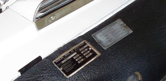

I have attached a copy of the karosserie plate

Sorry to bring this topic up after so long, but I have been working steadily on the raised lettering "problem". I am almost there, and have attached some images of an options plate with raised lettering. This is from my own 450 SEL 6.9, and this plate is now a template for further options plates. There is still some work to do, such as the corners of the plate need to be cut at 45 degrees to replicate the original.
The chassis plates represent a bigger logistical problem, as the plates need to be produced in Germany (with lettering but without the raised numbering) then sent to Australia for the raised stamping, so really bit of a nightmare, but perfection will eventually win out ! What all of this means is that they are going to be somewhat more expensive than the current style of chassis plates.
The next step is to have some chassis plates made and sent to Australia for the stamping. I hope to have this completed by Christmas and some images available.
Raw metal plate
Reverse
With a coat of paint
WIth and without paint

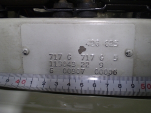

Hey Craig,
My early 250SL DATA PLATE shows the numbers are JUSTIFIED to both the left and right.
Is it possible that MB used different standards on different models?
early 250SL data plate

Absolutely ! Nothing they ever did was standard between models. The only constant appears to be that they used the 4 lines, and that is the part I am most concerned about. As long as they use the 4 lines, I can adjust the alignment accordingly.
