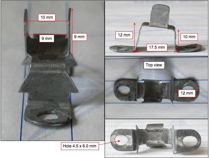

Benzportland,
if you plan to go further with this here are the dimensions of the clip and a better color rendition:
and the metal insert:
I'll be happy to email you the high res pictures.

Thank you for the research and measurements! We would need to send a pair of these in for the moulds.  I am not sure about the metal stamping, I will check and see if the guy I have been talking too has any ideas for that piece; I know it is possible but usually much more costly for that type of work.

Okay I have an estimate on the metal clip pieces - thanks again Alfred for the detailed specs on the clips.  I contacted a firm recommended to me called "Small Quantities" which specializes in metal reproductions such as fasteners, etc in relatively small numbers.  There would be an engineering fee of $450.00, and then the clips would be $4.90 each for a quantity of 100 to 149, 4.50 for a quantity of 150 to 299.  So if we did a quantity of 100 (50 sets for example) this would add $14.30 to each set, if we did higher quantities it would be a little less.  I am assuming sets with the metal clips would work as replacements for non-clip pieces.  So, a total for pieces with metal clip inserts should be around $40.00.  This is a little more money, but probably well worth it for some, and yet there are others who will probably just want the one-piece clip.  I suppose we could do some of both as well, that would just take a bit more planning.

Hi benzportland,
thanks for doing all the leg work here.
My view is to go with a solid piece without the metal clip.  It is not only the fabrication  of the metal part but also the design of the plastic.  Looking from underneath it is not just a rectangular cavity but quite intricate, and matching both pieces will require additional work. Especially when they are made in different shops.
The clips in modern cars are all one piece plastic and they seem to be quite durable.  You mentioned earlier "We would need to send a pair of these in for the moulds".
Perhaps I misunderstand what you mean  but I believe that one clip is sufficient since there is no left or right version.  And this is important,  the clip must be symmetrical along the long axis, that is, fit both sides!

Alfred - I wondered about the aspect of the metal clip fitting just right inside the part, and so far I have not been able to find a shop which does these simultaneously.  And you're right it did not occur to me we would actually only need one mould for the plastic so the price should be a bit cheaper.
