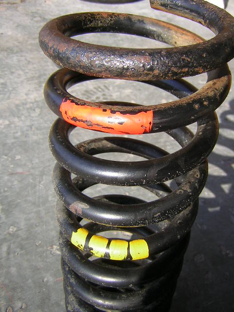

Removal and refitting of rear springs and rubbers: First, make sure you get the right thickness rubber pads. All original springs are colour coded (See photo)
Download Attachment: Spring colour code RED.JPG
63.12 KB
This one is coded RED. I found the 4 yellow marks confusing - they are not part of the code that tells you which rubber pads you need. The RED code is important. WHen x-ref'd with the BBB it tells you what tickness pads your car was originally fitted with (related to things like the number of add extras it was built with such as AC, power steering, etc). The red mark was covered in crud and so I didn't find it until we'd removed the spring.

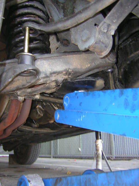

So: if required spray all bolts you intend to work on with duck oil or wd40 (duck oil is better as WD40 is hydroscopic) the day before and let the oil penetrate. Day 2: crack off all the bolts with the car on its wheels to avoid jerking the car around on stands. Jack the car, put on stands as shown at the back of the photos. Place the jack under the lower control arm (see photo below) and raise the jack until it starts to compress the spring (it will lift the car a little off the stands; if it lifts it a lot, adjust the jack positioning and try again):

Note that the jack plate looks like it is barely on the arm - first, if you have a rubber block jack plate which has more grip, use it. HOwever, note that as you put the jack up and down, the amount of control arm in contact with the plate will change. However, in our case this was not a big problem because of the size of the jack - it was not about to fly out from under the car under the pressure of the spring - the same might not be said for smaller trolley jacks.
With the 4 bolts undone (we also did the control arm busing as well so you can see the new one half in place in the photo) gently lower the jack decompressing the spring.
Download Attachment: Releasing spring tension using jack.jpg
55.39 KB
Out pops the spring, at which point you can change the rubber pads. Mine were OK, but brittle.
