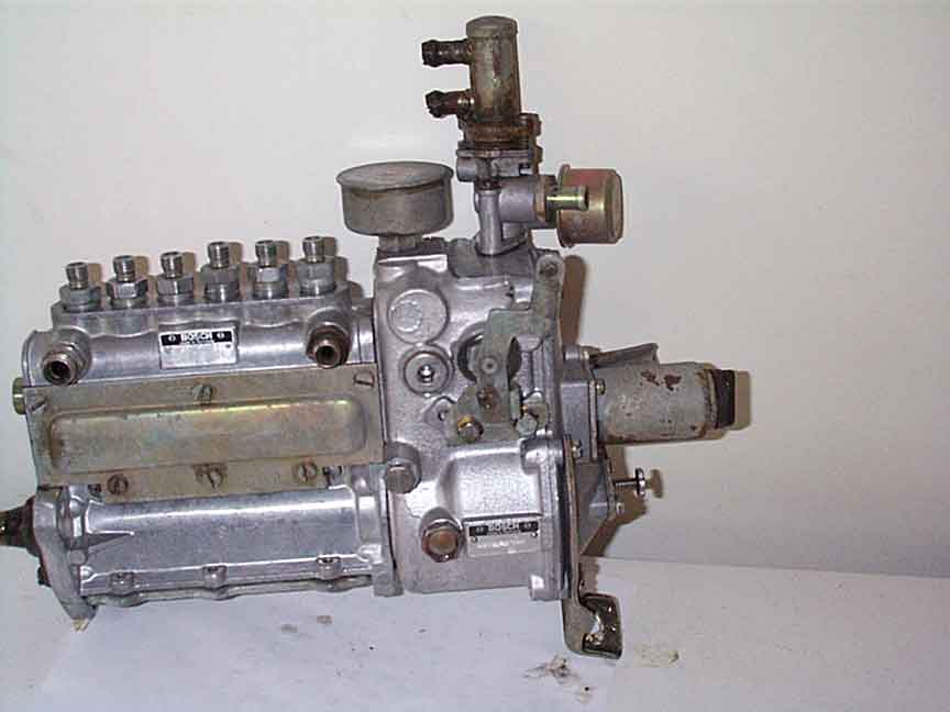

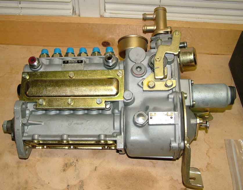

Here's an update on my injection pump and cold start valve (CSV).
I received both IP and CSV back from Hans at H&R.  See attached pics of before and after.  Summary, took a lot of time to remove and re-install!!!!  but, now the car runs like a dream!  When I first started the car after installing the rebuilt IP and CSV, the car started right up...  as it ran, it started to run poorly and there was a strong smell of gas.  It also back fired when I pushed the linkage and let off of it.  Called Hans and we spoke about the problem and possible solutions.  We agreed that I need to check the spark plugs.  Maybe the oil was saturated with gas from "before" I sent the IP and CSV to Hans.  I pulled the plugs and sure enough, plugs were caked with black soot, carbon (fyi, these were brand new plugs).  Anyway, I then drained the oil.  I have never seen oil like this before.  It ran out like water!  Smelled very strong of gasoline.  The oil filter was clean but smelled of gas!  I replaced the oil and filter, and also installed yet another set of new plugs.  At this point a few $ more...  the wife is already mad so it wont make a difference...  The car started right up!  A little black smoke and smell of gas.  No back firing!  Today I took the baby on its maiden journey.  It ran great!!!  Filled the new gas tank with fresh new gasoline...  drove highway and in stop and go traffic.  I even put the top down.  Today in Memphis it was sunny and very nice.  I did run the heater however...  I checked the plugs tonight and all 6 look very normal.  A nice, slight greyish color!  I am soooo happy!
If anyone needs advice or help with replacing their IP, CSV or gas tank, please email me or post a new post on our website.
Note: I also ended up buying 6 new injectors.  Hans told me that all 6 of mine were bad.
To all that helped me, thank you!  A special thanks and hello to Joe and Mary...
Download Attachment: ip-before.jpg
27.76 KB
Download Attachment: ip-after.jpg
36.9 KB
Download Attachment: csv-before.jpg
33.01 KB
Download Attachment: csv-after.jpg
27.14 KB

Good job Bob,
Glad to hear it worked out, but sorry you had to do so much work and went over budget. Hopefully the experience and knowledge gained will continue to save you time and money in the long run not to mention the satisfaction from doing it on your own!
