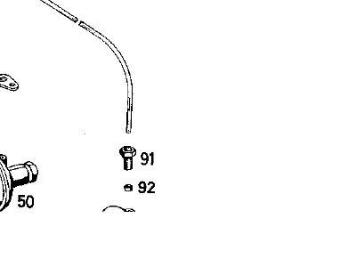

I wanted to share there are some parts available for the 051 distro set up.
1. the vacuum line from the throttle body to vacuum retard unit
 0001581435 Vacuum Hose/Line; White; 4mm OD; Bulk  $0.98 per meter
I bought mine from arizona auto haus
2. the lock ring 003862-00400 "ring"  1.27 each from mb classic center
this is the lock ring that goes between the vaccum retard unit inside the threadded fitting.
I will try to attach a photo showing this par it is part 92

Finally, here is the image
Download Attachment: distro parts.JPG
