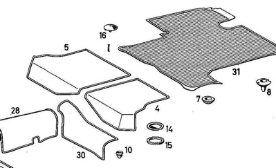

Pat,
on my 230SL this is a simple round rubber plug, not a one-way valve plug.
The spare parts catalog describes part #10 in the picture as "Rubber buffer (to plug holes)" that is used in several places including "in hand brake covering", perhaps it is the one you are looking for.
The p/n for this item is 110 987 0039.
