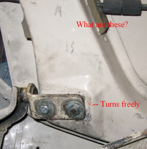

We have a different hood issue.  Our hinges are not rusty, everything moves fine, but it is a little out of alignment.  In attempting to re-align the hood we discovered that one of the bolts won't come out.  It just spins around.   We've tried applying outward pressure on the washer while using a socket wrench to loosen the bolt, but it hasn't worked.   Here's a picture of the bolt that turns freely but doesn't tighten or loosen.
Oh, and in the picture, there are also these two things that are on the torsion bar that holds up the hood.  They don't seem to be serving any function - they can move freely.  What are they?

The nut-fixture inside the hood cavity needs to be repaired or replaced. See hood hinge repair thread: http://www.sl113.org/forums/index.php?topic=7019.0
Quote
I believe these are rubber bumpers meant to prevent contact between the hood spring and the hood. They should be supple not hard, and they should be spread evenly across the span of the spring.

1.  Inside the hood, is there somethng that is basically the same as Gernold's captive nut kit in there?  Is that how MB did this?
Pretty much. Unfortunately, the dealer parts manual does not show this explicitly (it is part of the hood).
2.  Is whatever is in there attached or free-floating in the space provided?
The nuts are free to move laterally, but not allowed to turn. In your case, the cavity in which the nut is held captive has widened to such a degree that the nut is no longer prevented from rotating.

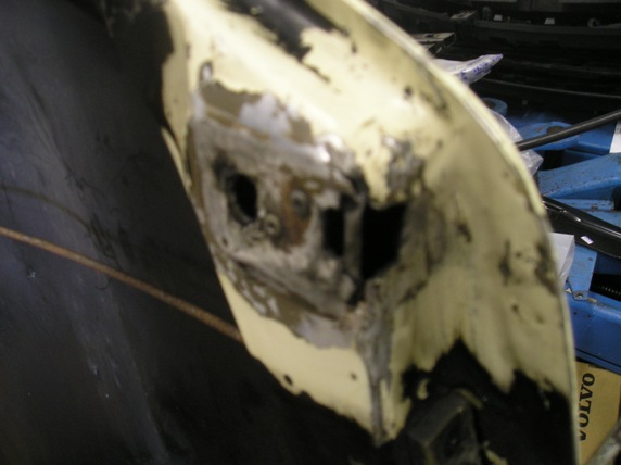

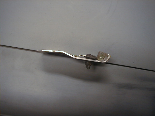

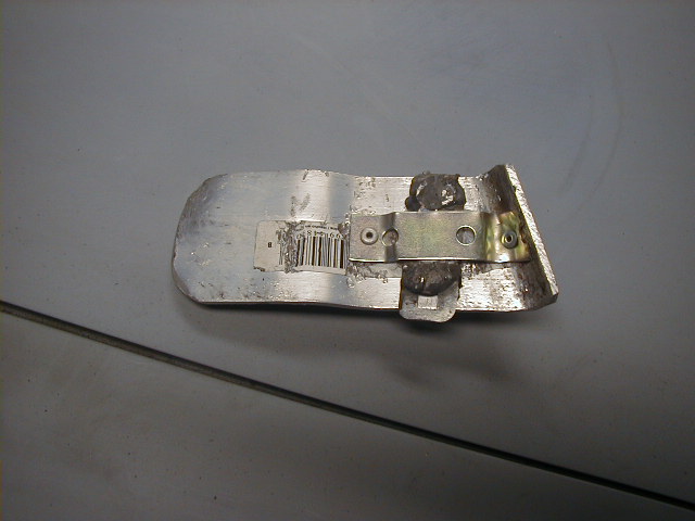

Scott, I am less technical than many on the site but I ordered the kit from Gernold at SL-Tech (thanks to Aqas and others from site for recommending) They cost $42 a piece but he recommends doing both sides once the hood is removed...Mercedes apparently made a flimsy design in this area of hood.  Yes, you will have to make a small slit to get the rectangle bracket installed but a skilled welder can apparently seal this area back up.

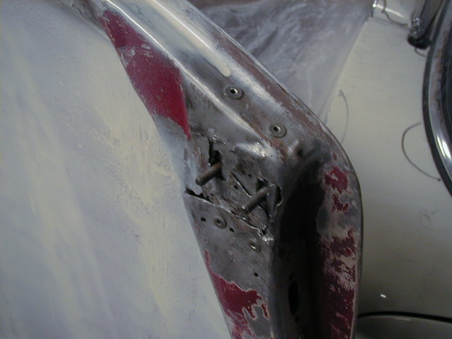

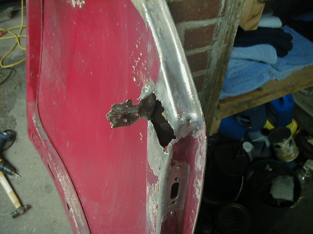

A member of the German Pagoda group posted an article showing his way of fixing this problem. Although the text is in German the pictures are self explanatory.
Go to: http://www.pagodentreff.de/diskussionsforum/t5365-haltplatten-motorhaube.html
Scroll down to the second post by Bochy3699 and download the PDF file:
"Käfigmutter Haube ersetzten.pdf"
