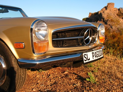

Hello Graham,
I have had very good luck with De La Torre Plating located at 6887 Farmdale Ave., North Hollywood.  (818) 764-4372.  Over the past few years Jose has replated front & rear bumpers and other bits on my 1970 280SL.  He specializes in automotive chrome plating.  I've seen his work on a 1948 Tucker and a 1948 Franay-bodied Bentley with more chrome than you would believe.  He has been in business for a long time and takes his craft seriously.  He delivers on schedule, which I understand can sometimes pose a problem.  Not cheap, but you don't want a cheap chrome job.
Jackson
